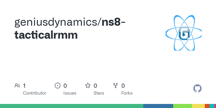

Hello @mrmarkuz I have not yet built meshcentral module, good thing is that, once meshcentral is done, tactical could reuse…
@Andy_Wismer that was public knowledge for the first year the product became available, way even before it became popular, and if you were a member of discord would have had that knowledge.
No one asks you to use it Andy, after all Teleport is also a fantastic alternative by a very large corporation, maybe you would trust those.
The github, incase you’re wondering

I think we’re making good progress so far…
@mrmarkuz Could help me in sorting out the issue with nginx in tactical rmm
https://github.com/geniusdynamics/ns8-tacticalrmm
