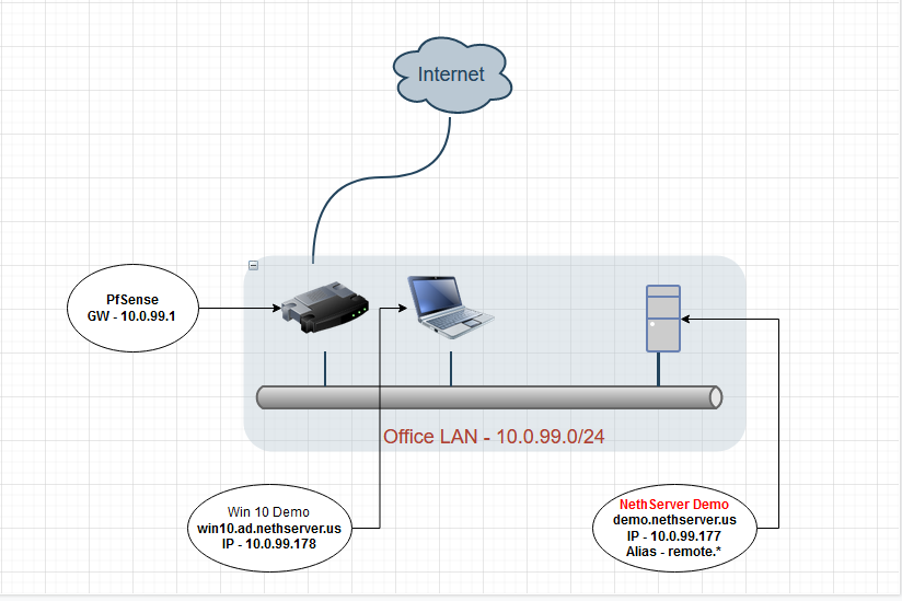

Assumptions & Scope:
Office LAN Network: 10.0.99.0/24
PfSense Gateway - 10.0.99.1
NethServer VM 1 NIC - Static IP 10.0.99.177
Host Name - demo.nethserver.us (ns-example.yourdomain.com)
Alias Name - remote.nethserver.us

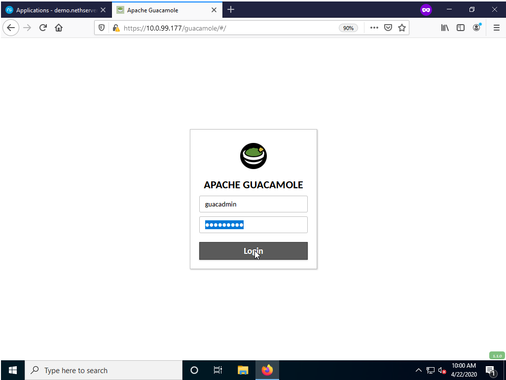

After confirming the installation process has completed, access to the Guacamole service can be reached at https://YOURNETHSERVER/guacamole (https://10.0.99.177/guacamole for this demo) with the credentials below:
Username: guacadmin
Password: guacadmin
