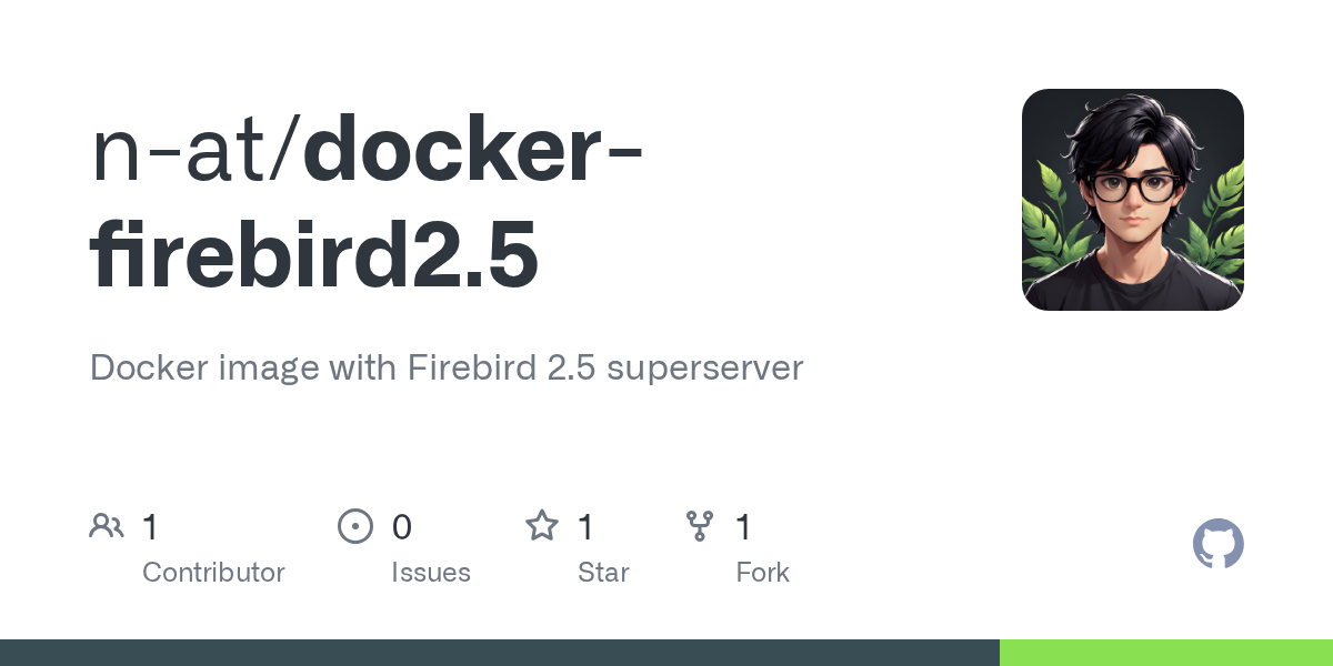

I cleaned up the source code and released version 1.0.0.
Unfortunately, I can’t get the repo to be added to NS8 because I can’t add a fork. I get the message shown in the image:
What could be the reason for this? Am I doing something wrong? How should I solve this so that the repo is available under NS8?
Thank you for your help
Did you follow the instructions about creating your own repo? See Create a ns8 repository for developers
You don’t need to fork your app project, it’s about forking the ns8-nethforge github project. That fork will be your NS8 repository.
