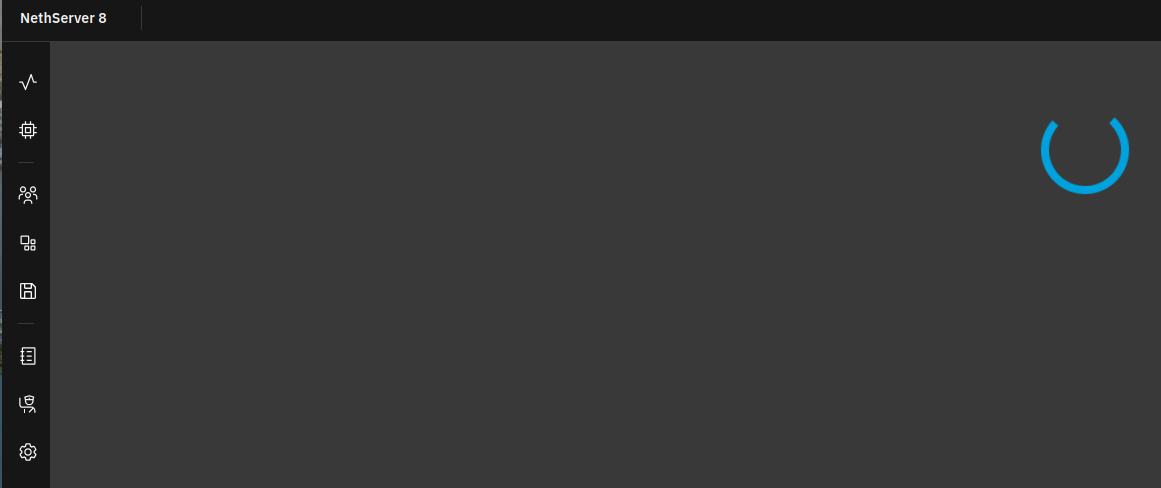

I messed up again. I modified the files in the repo, but I couldn’t create the Firebird port opening and closing configuration window. As a result of the modifications, only the following screen appears when I load the Firebird Settings:
You could build the UI online, so you can see changes to the UI immediately and it’s also easier to catch errors, see also How to build your UI online while you are coding

I messed something up. I tried to restore the firewall port opening/closing state before the modification but it didn’t work, same error and screen. I can’t restore the last working state, even though I deleted it and restored all files to their previous working state. I cleared the Firefox cache, restarted the Firebird app, then the entire NS8 but it didn’t work.

You restored the previous state but the validate-input.json and validate-output.json contained a wrong comma.
At the last element "tz", the comma is not allowed in JSON, it should be "tz" without the comma. It’s confusing as for example in JavaScript it’s allowed.
Another explanation is that the comma in JSON is a delimiter and not a terminator.

I recommend to check the json files using jq as it outputs the error:
[firebird3@node state]$ cat ../actions/get-configuration/validate-output.json | jq
parse error: Expected another array element at line 18, column 5
See Trailing commas - JavaScript | MDN for more info.
I’m going to check the work you’ve already done to implement “opening/closing the firewall port”.
Thank you very much. In the meantime, I compared the local ns8-firebird backup directory with diff and it immediately showed me where I made a mistake. It was exactly the problem you found. Thank you.
I fixed it and now the world is back to normal, Firebird is working again.
