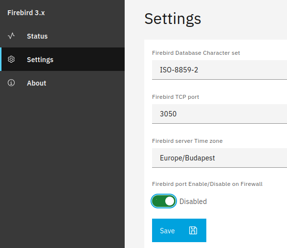

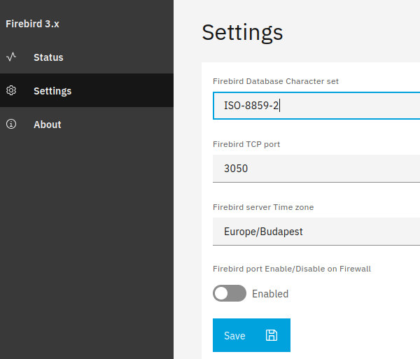

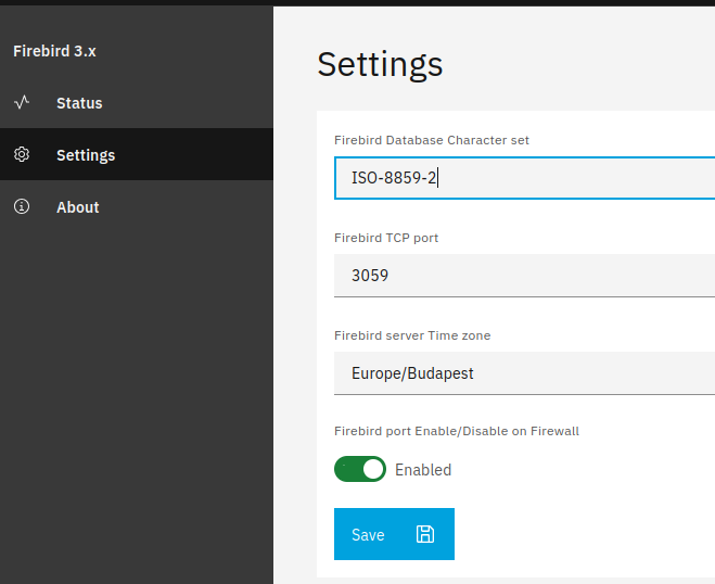

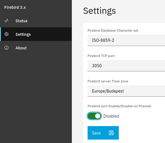

I changed the button setting to Enabled on the left and Disabled on the right in the Settings.vue file. After clearing the browser cache several times, it finally displayed the set state.
However, after further changes, it no longer appears. I don’t understand what happened, it displayed the state correctly for a while, but now it doesn’t.
Could you test it?
Thank you for your help
One detail escaped my attention. When reversing the button state worked, the 70firewall file was also originally modified to reverse the condition you suggested. The two together solve the problem according to sensible control.
Based on the displayed captions, it now works fine for me. Enabled opens (allows) the Firebird port on the firewall, and Disable blocks (closes) it.
I checked the operation locally and via VPN with Telnet. Firebird is continuously accessible via VPN regardless of the setting.
In the current state, the Disabled marking is “Green” contrary to the original logic, but changing this would be possible by modifying the css and/or js files, but this would probably override the settings of similar buttons, so I would not deal with this.
Please check it out and share your comments with me.
That’s ok, via VPN you can always access it.
Did you change the caption of the toggle? I’d revert it as green should be enabled and grey should be disabled, anything else is confusing IMO.
I have restored the button to its original state. Enabled is marked Green and Disabled is marked Gray.

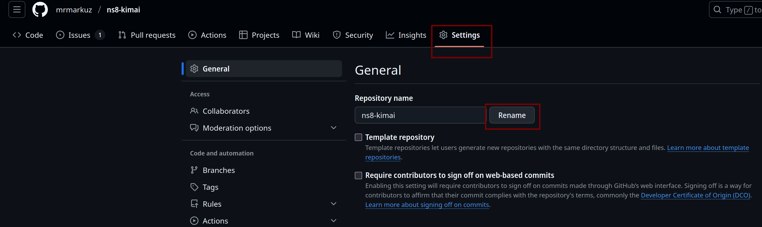

That’s because you didn’t release a stable version tag (ie. 1.0.0) and put it to a repo yet. That’s the requirements to be able to install the app from Software Center.
Without it you need to install manually from CLI.
In the Github settings you could rename it but I’d leave it as is and try the firebird version dropdown.
I don’t know about the hyphen and points but a number should work, for example GitHub - geniusdynamics/ns8-n8n: NEthserver 8 Module for n8nio
As said, I’d try to use the dropdown instead of different firebird projects.

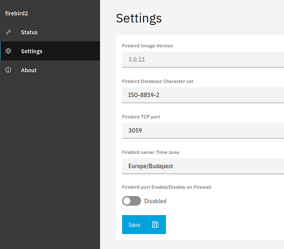

I opened a Pull Request using a textfield instead of a dropdown as it’s easier just to show how it could work.
I found that when you change version from 3.0.11 to 5.0.3, it doesn’t work without removing the volume.

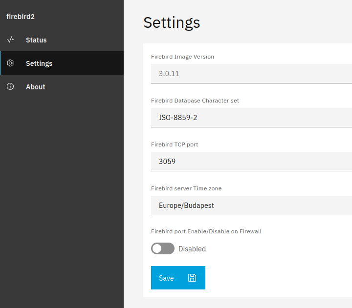

I tried to edit the files on my computer based on the PR, but either I messed something up or unfortunately there is an error in the PR because I get the following error message.
After the modification, the previous data in Settings will disappear and you will have to set it up again, but due to the error message, you cannot…
However, the Version text field does not appear in Settings. I cleared the browser cache, restarted the firebird container and NS8, but nothing has changed so far. I was forced to restore the previous state for now.
It occurred to me that validation-inpu.json and validation-output.json were not modified. Could this be the cause of the problem?
You changed more than there were in my pull request for example this and this which could be the cause of the error from the screenshot.
I can’t reproduce, it’s there after upgrade and fresh install…
No, I don’t think so. The new firebird version field isn’t validated which of course should be done but it shouln’t break the configuration.
I reinstalled the app from my repo and configuration worked without errors.
I applied the PR to avoid possible errors of manual editing. The Version text field still does not appear on the Firebird module Settings page. I cleared the browser cache and restarted NS8 but the Version text field still does not appear on the Settings page. This is the case on Rocky Linux.
I installed NS8 on a Debian and after that update the Version text field appears without having to clear the cache of the same browser or restart NS8 on Debian.
What’s wrong with NS8 running on Riocky Linux? This problem occurs with every update on Rocky Linux…
