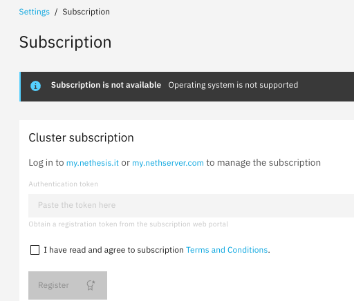

Are there any plans to support NS8 in Debian? I get this message in the subscription section.
Unfortunately not at the moment. Read here.
@MrE
It IS possible to set up a Rocky Instance, and migrate all Apps from Debian to Rocky, which IS supported.
At least a “backdoor” for a subscription…

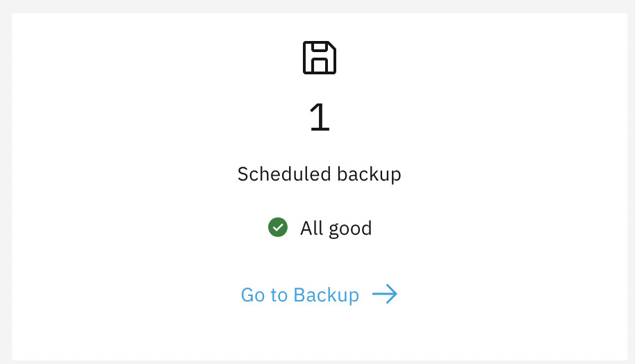

But to the subject of this thread, NS8’s error handling is inexcusably poor, and the backup situation is a good example of it. Not only does it not email the admin on a backup failure (which it ought to do, without a subscription or any kind of custom scripting–and it doesn’t do even with a subscription), it lies to you on the cluster status page and tells you everything is fine with the backup. All it means is that you’ve configured one, not that it actually works. To find out if there have been errors with the backup, you have to browse to the backup page, find the scheduled backup you’re interested in, and click on See Details–then you’ll see if the last backup succeeded. A handful of apps will report this on their own page, but there’s no consistency there.
@davidep, this is just unacceptable. If a backup fails, NS8 needs to notify the admin directly. It needs to show this clearly on the main cluster status screen, and if the system’s capable of sending email, it needs to do so. With as much as it complains about backups not being configured for any app, there’s just no excuse for this shortcoming. NS7 was far from perfect in its error handling, but at least it got this right.

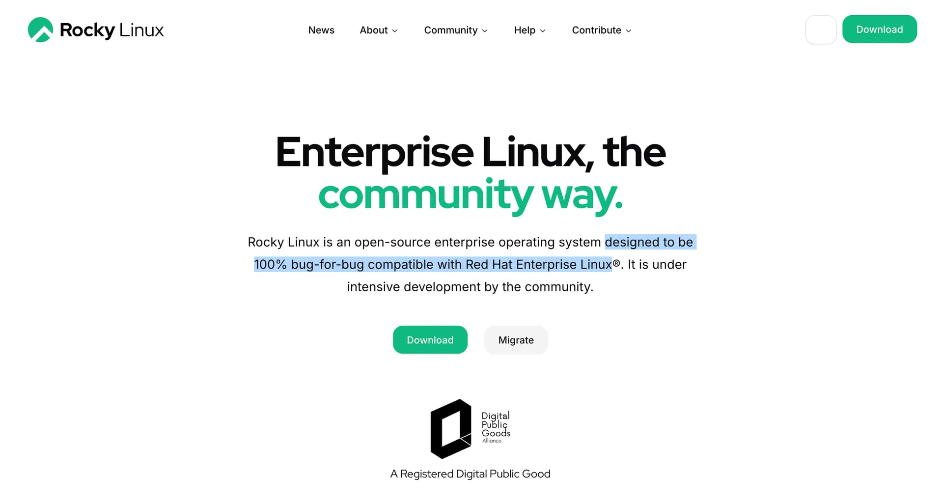

It seems that Rocky still pushes “designed to be 100% bug-for-bug compatible with Red Hat Enterprise Linux” as their major “Raison d’être” (Reason to be / exist).
As it’s per definition a 100% bug compatible clone of RHEL, I really wonder what is under intense development by what community?
→ Maybe they contribute to the packaging graphics? :slight_smile:
Debian, on the other hand, is still pushing the borders what a rock solid, stable Linux can achieve.
And it’s been doing that longer than Rocky, or even RedHat has!
In that sense, its obvious to me that Rocky Linux is a second-class citizen in terms of Linux and Open Source. It’s not enhancing anything, it priorises getting bugs cloned 1:1 correctly!
And if they keep their word (Not that I trust anything from RedHat, nor any clones), this will NEVER change - Rocky wants to remain a bug compatible clone!

…and that really is the problem. If backup is important–and the devs know it is, and NS8 obnoxiously warns the admin if there’s a single app for which it isn’t set up–then it’s no less important that the admin be notified if the backup fails. NS8 is perfectly capable of sending email regardless of the underlying OS.
That’s what any sensible admin would think it means, yes. But what it actually means is that you have a backup configured for all installed apps. Agree that it’s very misleading, as I noted above.
@danb35
Actually, showing this “badge” on the page “Cluster Status” with “All good” written with a green tick implies the last backup worked, not the backup is correctly set up…
It’s worse than both of actually think at the moment!
This is VERY misleading!
…and as I think more about it, NS8 supports email notifications, and complains if you haven’t configured them. But I don’t think I’ve ever seen it send any…

Thank you for reporting the issue with the Cluster Status page. It appears to be a bug: Failed backup not reported by Cluster Status · Issue #7241 · NethServer/dev · GitHub
