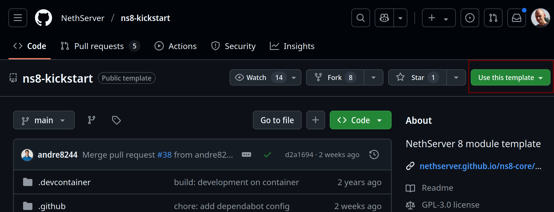

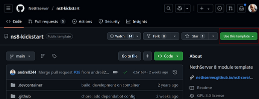

I have a github login, but how can I create a project using Nethserver/ns8-kickstart so I can install it on Nethserver?
I guess I should have access to the repo for the publishing… Or is it possible to install the module on NS8 without it?
Thank you for your help
It’s explained in GitHub - NethServer/ns8-kickstart: NethServer 8 module template
Login to GitHub and click on “Use this template” to create a new repo out of it.
You change the code and push it to the repo and a GitHub action publishes a package that you can install on NS8 using add-module, see also Quickstart | NS8 dev manual
In this case the name is written without “ns8-”
add-module ghcr.io/steve/firebird:latest 1

I think you need to change the repobase from nethserver to your github name, see also ns8-onlyoffice/build-images.sh at main · mrmarkuz/ns8-onlyoffice · GitHub
