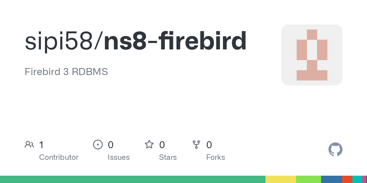

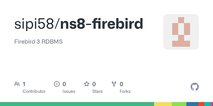

I just now realized that I didn’t provide the link. I remembered that I had sent it earlier…
or
ghcr.i/sipi58/firebird:latest
Please note that it is still in a very early stage, because for now I am trying to implement the config under scratchpad as a standalone pod…
Firebird is running under scratchpad, I was able to upload the existing databases and the modified security3.fdb. Windows client can connect to firebird running under scratchpad and the databases are accessible and modifiable.
I would like to achieve this with firebird pod as well…
Afterwards, there are still many small things to be solved, such as creating a Firebird user, setting the Firebird port, uploading databases, setting the database character set, etc.
