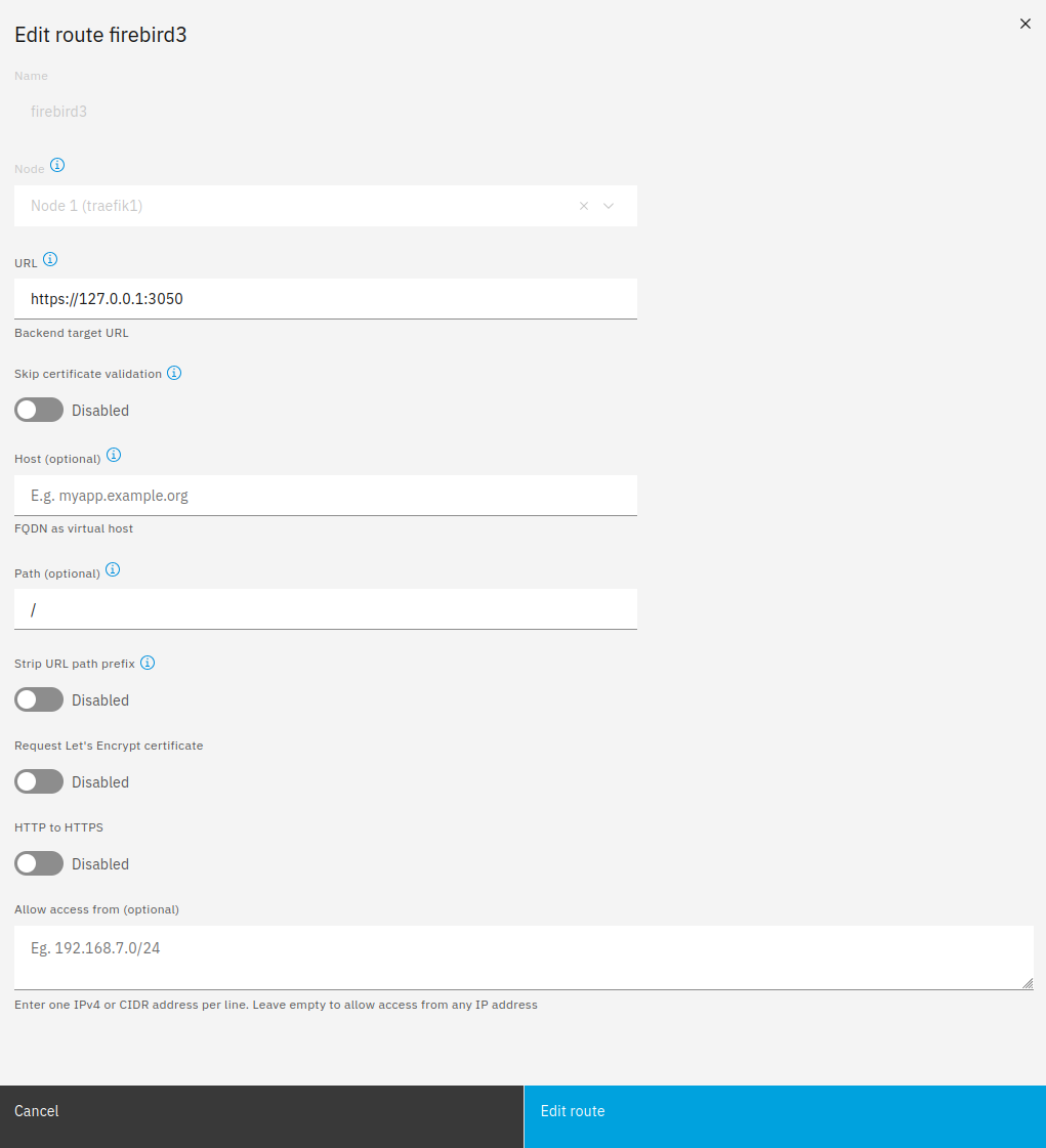

I created a new route under HTTP Routes.
Unfortunately, I can’t reach firebird on port 3050 with telnet. Even if I change the Path (optional) value to /firebird, it doesn’t work. Firebird’s port 3050 should be reached via the route IP_address:3050, am I setting it wrong?

A http route shouldn’t be necessary but I think you need to open the port in the firewall.
As root enter the following to open port 3050 permanently:
firewall-cmd --permanent --add-port=3050/tcp
firewall-cmd --reload

I have a lot of things wrong. Under NS7 I open the port on the firewall, here I thought HTTP routes would do it for me, if I set it up. I was wrong. I also think I misunderstood that under NS8 there is no firewall, instead there is Nethsecurity, because according to them there is a firewall after all… I’m starting to get confused about things.
Not to mention when I log in with which user, we run pod with pod…
Opening the port on the firewall immediately solved the problem, I can connect to the firebird server with telnet, it listens on port 3050.
