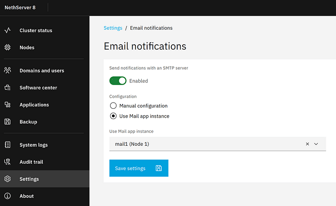

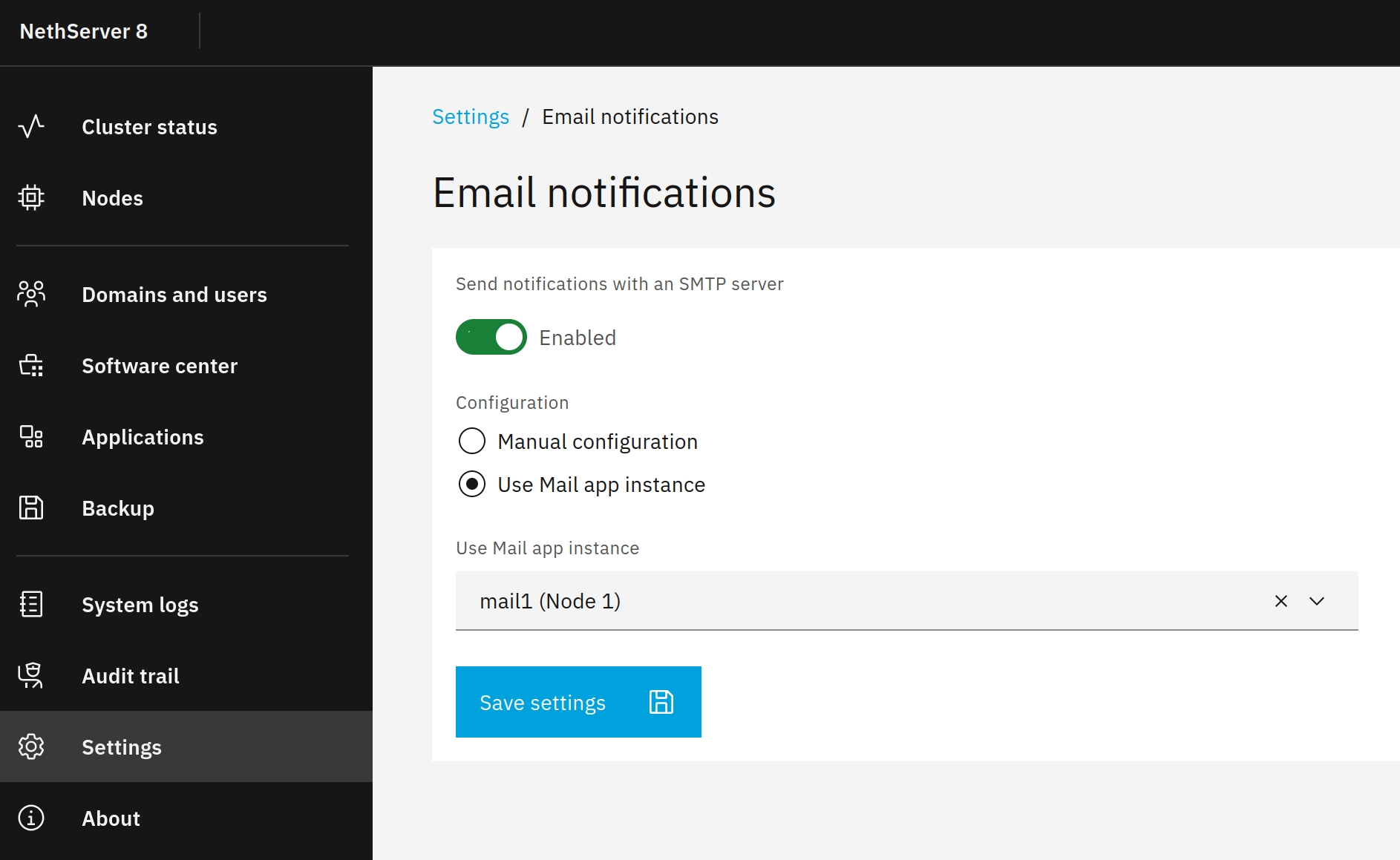

The system smtp mail settings point to relay 2 Basic settings), and i did not set that, but it’s the wrong MX. i also cannot cange that setting, so it is a setting that’s inherited from NS8. In the nextcloud data folder there is a smarthost.env file and if i VI that file to the right settings after entering the container with
runagent -m nextcloud8 bash
it just reverts to the wrong settings

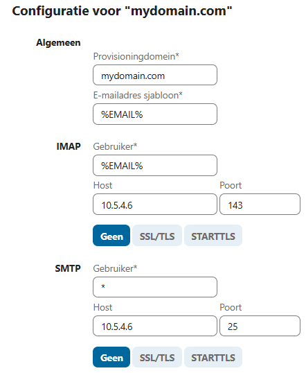

Here are working settings:

The smarthost.env is filled with data from the mail notification settings.
See also Email notifications — NS8 documentation

I’ve checked that page, but it doesn’t look like what i’m trying to do. It looks like the mail settings for an individual user, i’m trying to do the settings in the groupware settings, in this way that when a user logs in, they have their mail available without having to log in.
I have another nextcloud instance where above configuration works with these exact settings. When i add a new user in the Samba directory and log in with that new user, user can immediately use the mail app and start sending/receiving mails without further configuration.
I tried using the hostname also, with a valid DNS entry - no luck.
The NS8 mail app is very reachable from IP, since it does retrieve mails from the IMAP server running on the same node.
Ah that explains this. But these are in the basic settings, and i have it set up so the ‘mail provider’ setting uses the user settings, not the system settings. This is a working config on my other NXT instance.

I tested sending mails in Nextcloud and it worked when I setup the mail account per user but it didn’t work when I use the Groupware settings.
I used the mail server hostname, SSL encryption (port 993 for imap and 465 for smtp) and the mail address as username.
I found that even if a mail address is set for a user in the user domain, it’s overridden by the address that’s set in Nextcloud so maybe one needs to use %USERID%@domain.tld instead of %EMAIL%
