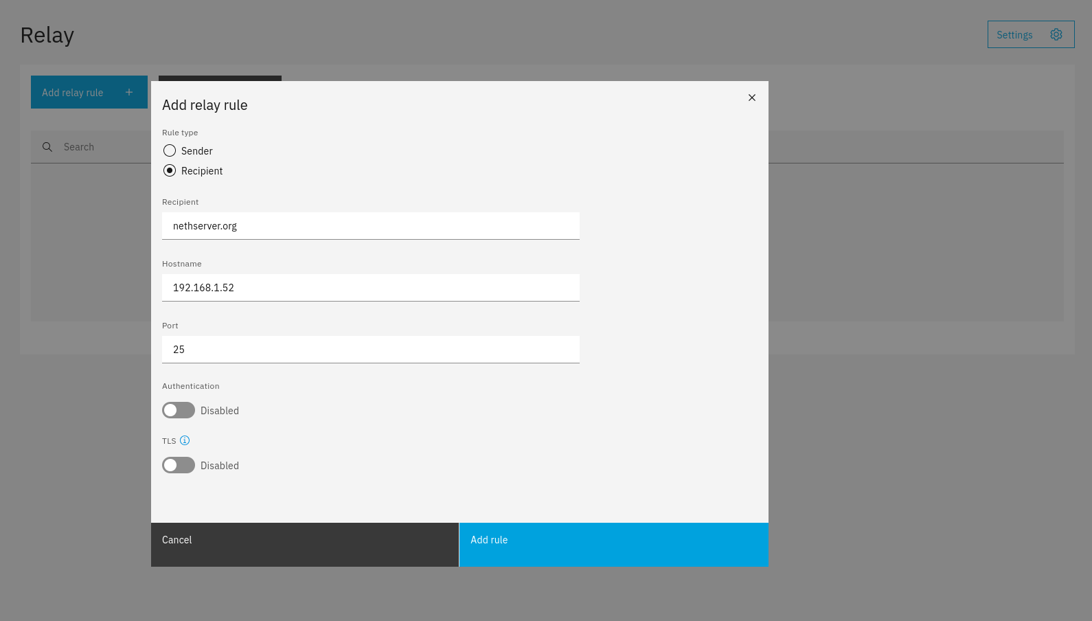

  3. Configure a recipient relay rule to route any message for the nethserver.org domain to the internal mail server. You can do this from the Mail “Relay” page.
    This step is required because the internal mail host likely lacks a DNS MX record, which Postfix normally relies on to route messages over the Internet. A static mail relay rule ensures that messages for nethserver.org are always forwarded to IP address 192.168.1.52.
