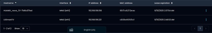

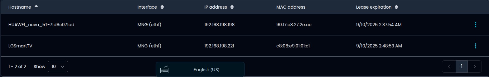

root@r:~# grep -i DHCPACK /var/log/messages
Sep 9 14:37:54 r dnsmasq-dhcp[1]: DHCPACK(eth0.10) 192.168.198.198 90:17:c8:27:2e:ac HUAWEI_nova_5T-71d6c071ad
Sep 9 14:37:54 r dnsmasq-dhcp[1]: DHCPACK(eth1) 192.168.198.198 90:17:c8:27:2e:ac HUAWEI_nova_5T-71d6c071ad
Sep 9 14:48:53 r dnsmasq-dhcp[1]: DHCPACK(eth0.10) 192.168.198.221 c8:08:e9:01:01:c1 LGSmartTV
Sep 9 14:48:53 r dnsmasq-dhcp[1]: DHCPACK(eth1) 192.168.198.221 c8:08:e9:01:01:c1 LGSmartTV
I have no idea why it only shows eth1 on the web.

When configuring the VM, I add two network cards
eth0 - which will use vlan > WAN1, WAN2, LAN
eth1 - (mng) this card is configured as access, whereby it receives a temporary IP/MASK/GW - while I configure WAN1, WAN2, LAN.
Then I only set IP/MASK, dhcp is disabled, but the dhcp server continues to respond.
In my case, I use management for access, but not through LAN or WAN. The strange thing is that even with the settings, the dhcp server still responds. A separate Zone has been created for this interface. It is possible that I am doing something wrong.
In this case, a separate interface for system management is just an idea.
Can you past the output of this command cat /etc/config/dhcp?
