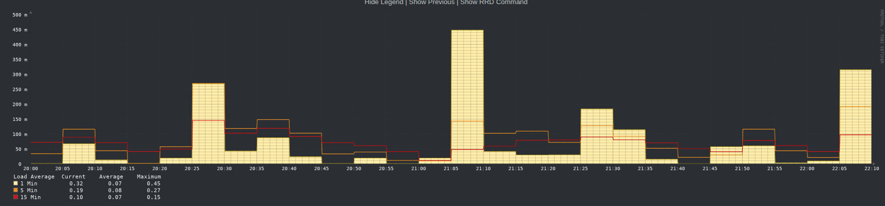

ping -c 10000 -i 0.02 -s 1440 IP
--- gw ping statistics ---
10000 packets transmitted, 10000 received, 0% packet loss, time 215927ms
rtt min/avg/max/mdev = 0.133/0.158/0.604/0.021 ms
gw - virt IP - main local gateway ns_policy ‘security’
--- IP_GW_ISP ping statistics ---
10000 packets transmitted, 9879 received, 1.21% packet loss, time 216699ms
rtt min/avg/max/mdev = 0.427/0.530/2.133/0.055 ms
10000 packets transmitted, 9859 received, 1.41% packet loss, time 215865ms
rtt min/avg/max/mdev = 0.441/0.546/2.294/0.060 ms
10000 packets transmitted, 9971 received, 0.29% packet loss, time 216140ms
rtt min/avg/max/mdev = 0.441/0.540/18.179/0.190 ms
snort stop
10000 packets transmitted, 9863 received, 1.37% packet loss, time 216123ms
rtt min/avg/max/mdev = 0.398/0.478/12.918/0.157 ms
10000 packets transmitted, 9880 received, 1.2% packet loss, time 215812ms
rtt min/avg/max/mdev = 0.401/0.481/15.303/0.197 ms
10000 packets transmitted, 9882 received, 1.18% packet loss, time 216109ms
rtt min/avg/max/mdev = 0.408/0.474/3.381/0.111 ms

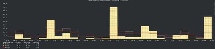

During the tests I was watching TV and there were no interruptions. With ping 0.02, the router might drop the ping :slight_smile:
load router
The load-a graph is during the test.
At first glance there are visibly no reasons for the interruptions, but after marking the traffic + qosity everything works normally.
