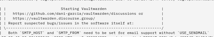

I am getting this issues
WHen i check the smarthost.env it has the SMTP Details
Any lead on how to solve them
@stephdl
Looks like it has something to do with the SMTP_HOST= and SMTP_FROM= in configuration

@stephdl are the configurations under Notifications menu in Ns8 loaded as smarthost configs?
here
Basically, if SMTP is defined with vaultwarden, and no vales are found, then the app will fail to work.
Equally, if values have been defined say by default, the app will think, you have working smtp and will make use of that for intial email authentication.

Also another issue i have realised smarthost.env is not loaded
