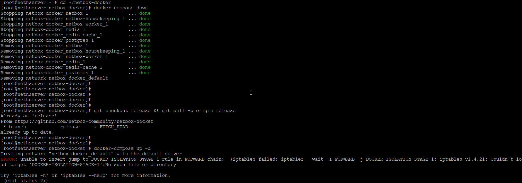

I think you need another “signal-event nethserver-docker-update” to restore the docker firewall rules…
Yes, looks good now. Testing the Autostart now…

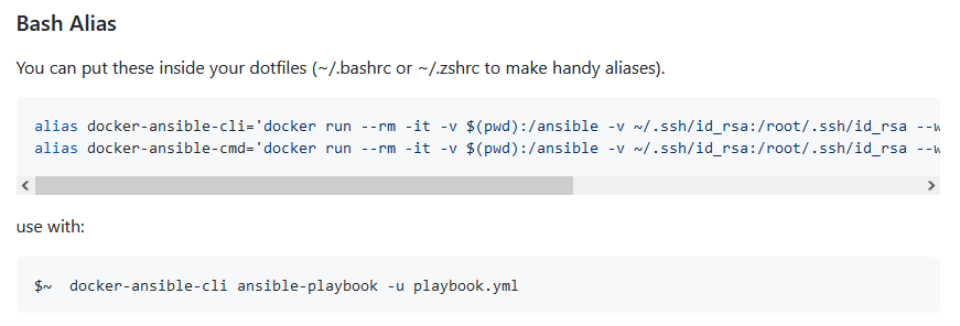

@mrmarkuz Can we also integrate/run ansible on Nethserver-docker together with netbox?
Please take a look: Ansible inside Docker for consistent running of ansible inside your local machine or CI/CD system.
Yes, just run use the “docker run” commands to get it.
