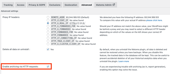

But I changed the archiving method within the Matomo Plugin.
Now, archiving reports works again when cron is not used.
If I disable the option again, the error occurs again.

before disabling Enable archiving via HTTP requests:

after disabling Enable archiving via HTTP requests:
