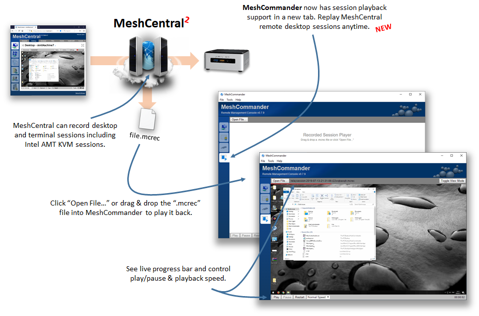

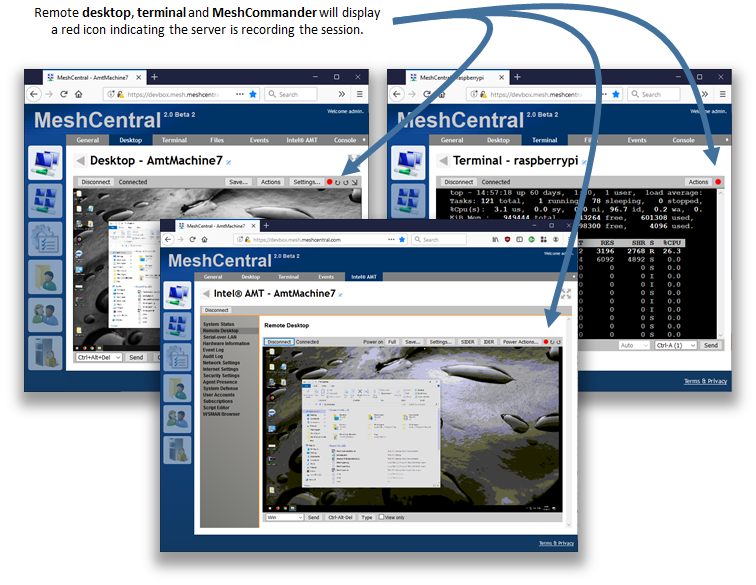

Once the option is enabled, MeshCentral server that already acts as a traffic relay between the browser, agents and Intel AMT will now record traffic automatically. Notice that if WebRTC support is enabled, the browser and agent will attempt to setup a direct connection to bypass the server. If successful, the server will no longer relay the traffic and will no longer record anything.
An indicator shows when recording is active:
Recordings will be saved in .mcrec file format, encoding session metadata along with traffic time, direction and in the case of web socket, the traffic data type. This file format is a re-playable TCP/Web Socket session, suitable for auditing.
Indexing is done in a separate process from the main MeshCentral server. Indexing works by recording the network traffic and adding timestamps and direction flags when writing the stream to a file. Indexing occurs after saving the file and the index is appended at the end of it. Also, there is a mcrec.js file in the MeshCentral folder you can run manually as a command line tool to index an existing .mcrec file.
MeshCentral Session Player is a web application that can take in a .mcrec and play it back. The player is accessible at /player or at /player.htm.
There is a âRecordingsâ panel in the âMy Usersâ section that can be viewed by administrators.
In addition to being able to record server side, users can now record browser side with a recording button (recording camera icon) on the bottom right of the remote desktop screen.
It allows users to start and stop recording at any point in the session and play the recorded portion back on the web-based session player.
