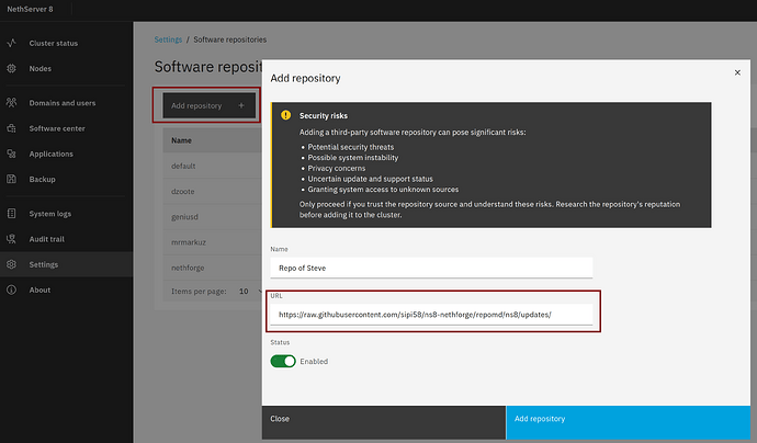

This is the right link to add your software repository to NS8:
https://raw.githubusercontent.com/sipi58/ns8-nethforge/repomd/ns8/updates/

That’s ok. It shouldn’t be opened in a browser, instead it should be added as Software Repository to your NS8, see Software center — NS8 documentation
It’s also shown in the last screenshot of Create a ns8 repository for developers

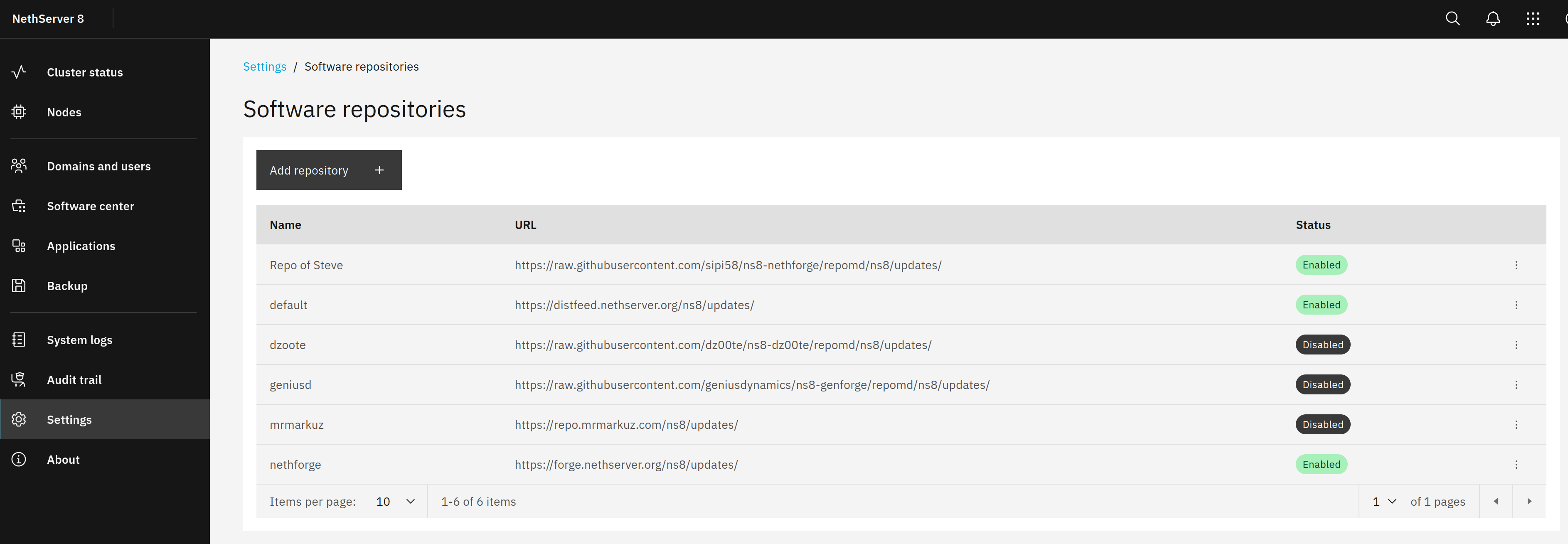

Here you can see the Software repositories on one of my NS8:
It lists your repository and the nethforge repository and some others. the default and nethforge repos are there by default, the others were added later.

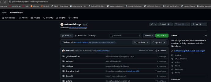

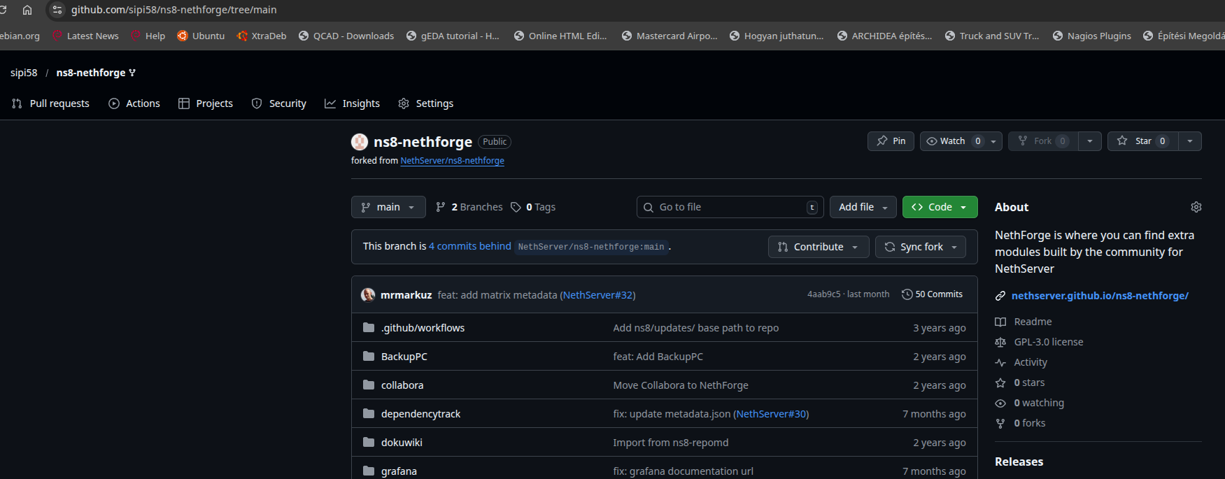

Sorry, I’m having a hard time figuring out what to do and I can’t get past this step. Here is a picture of my main ns8-nethforge repo. You can’t add a directory here, only a file.
If I understand you correctly, you should create a firebird directory here with similar content to the mariadb directory. Am I wrong?

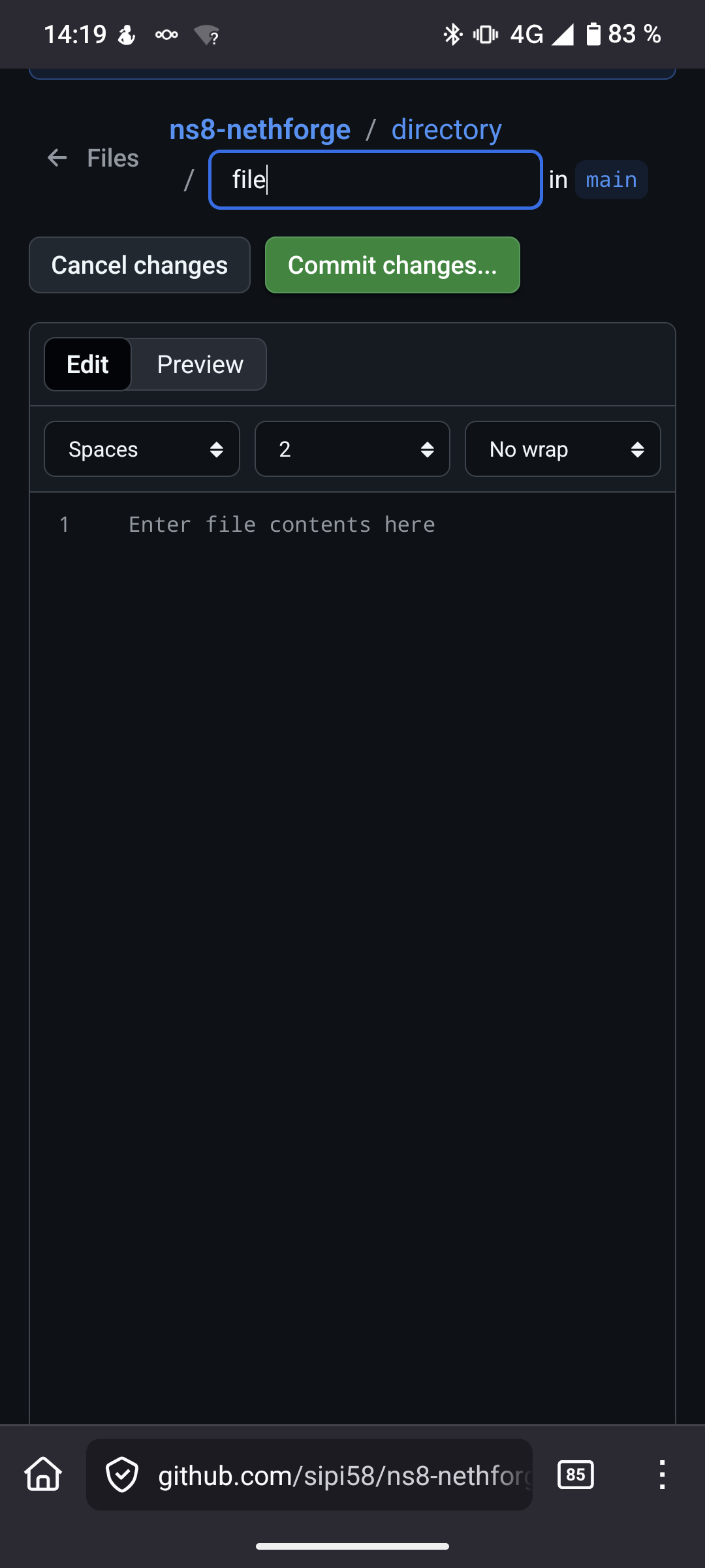

To create a directory with a file in it, you could write “directory/file”.
When you write a slash, a directory will be created.
Or you do a “git clone” of your repo, do the changes locally and push it.

I created an empty sipi58/ns8-nethforge/firebird/metadata.json file, logo.png and screenshots/screen1.png with a screenshot of Firebird Settings. You can check out Github - sipi58/ns8-nethforge
I hope I did it right… Please confirm this.

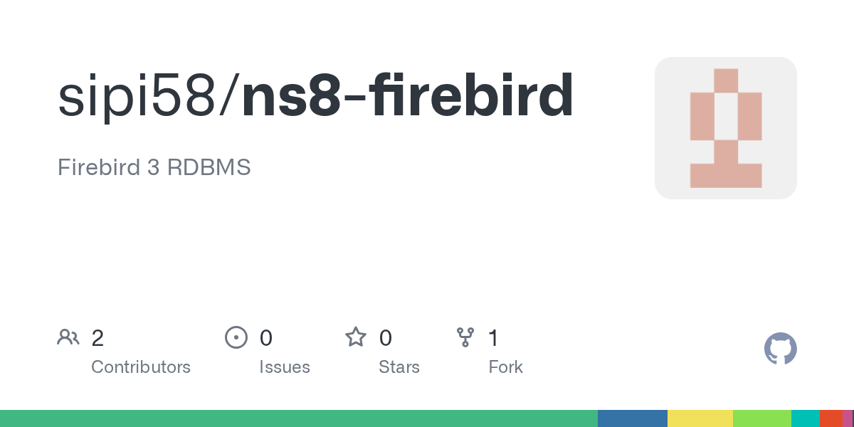

Yes, it’s correct. The app is in GitHub - sipi58/ns8-firebird: Firebird 3 RDBMS , where new packages are released.
The forked nethforge repo at GitHub - sipi58/ns8-nethforge: NethForge is where you can find extra modules built by the community for NethServer acts as own repository and provides the new releases of the packages from the app repo.

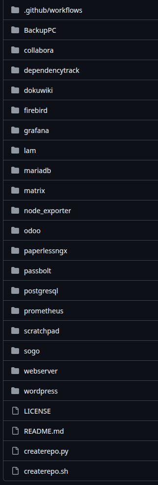

There is one more mistake, I did not delete unnecessary directories from my ns8-nethforge directory. What should I delete?
I think you should delete all directories from BackupPC to wordpress except firebird. Am I right or wrong?
I think the .gthub/workflows directory and the LICENCE, README.md, createrepo.py and createrepo.sh files should not be deleted? Am I right or wrong?

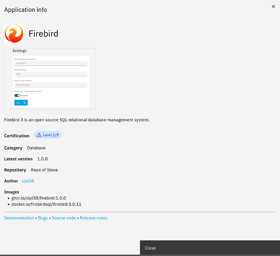

Great, it works, I can see your Firebird app in the Software Center after adding your repo.
Right.
Right.
@mrmarkuz Thank you very much for your help, this wouldn’t have been possible without you. I can see it in the repo now.
I deleted the unnecessary directories from my ns8-netforge directory.
