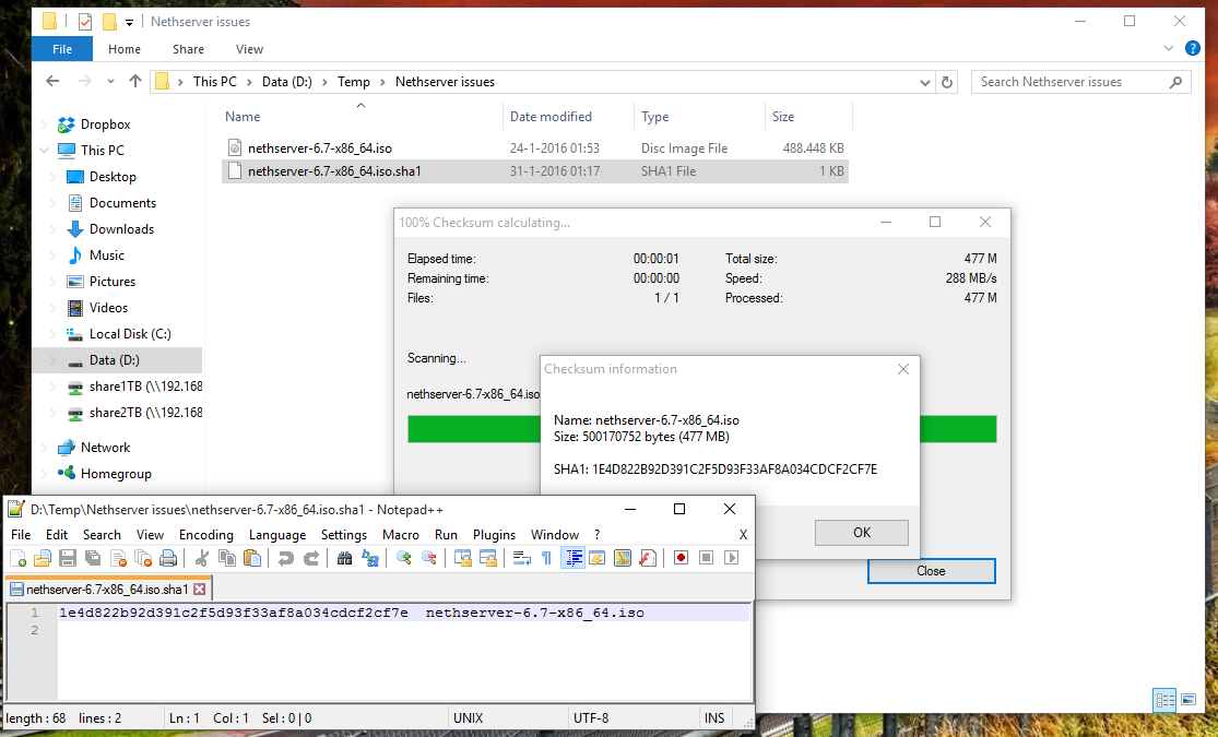

This is me, validating the ISO. The ISO is downloaded some days ago, but all their SHA-1 Checksums are the same.
