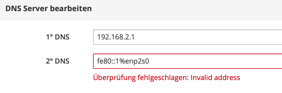

saving not possible
validator only supports IPv4 addresses
OMG - no IPv6-Support in 2020? :sob:
CentOS supports it but the UIs are not yet ready for it and no estimate timeline.
