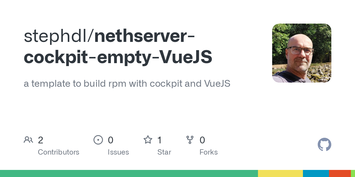

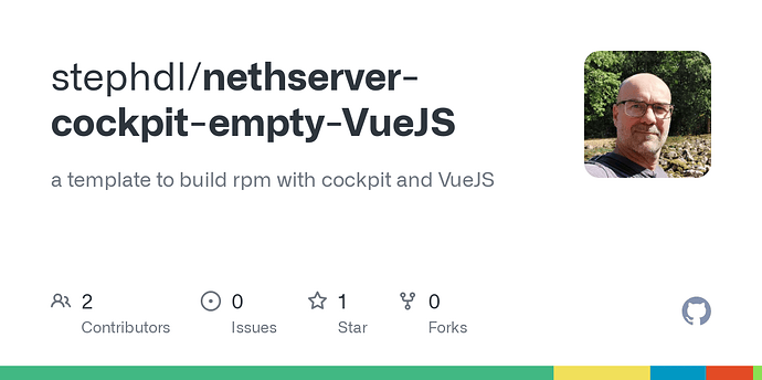

I started a scarfold of a rpm for cockpit vuejs, it is a starting point, after that you have to write your html/js/css but now you have several hundred thousand lines of code as example in the nethserver github repository.
