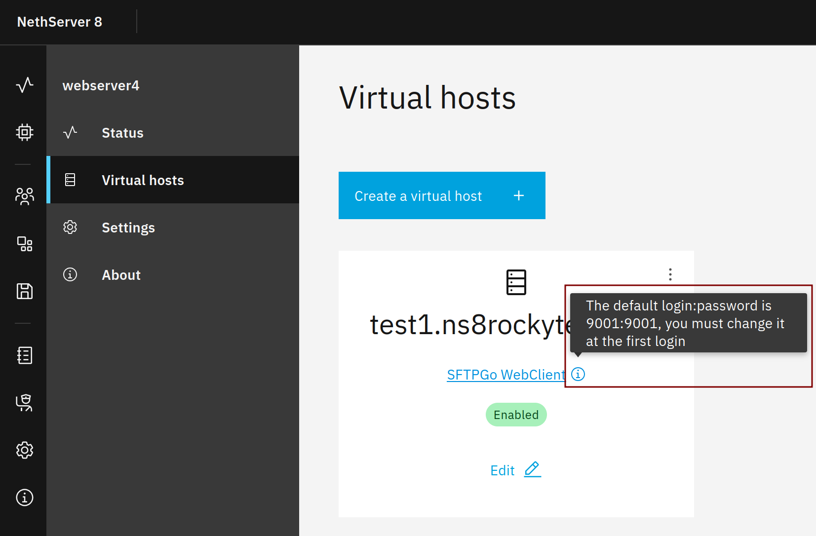

Did you create a user in sftpgo web admin? This isn’t necessary as required users are created when adding a virtual host, see also WebServer — NS8 documentation
Did you create virtualhosts for your website(s) and uploaded content with the right users? (starting from username 9001)
Thank you @mrmarkuz .
Yes, I created two virtual hosts and a user 9001 for the first virtual host and 9002 for the second virtual host. I logged in with the correct user and copied the website from NS7.9 to the the virtualhost in NS8.

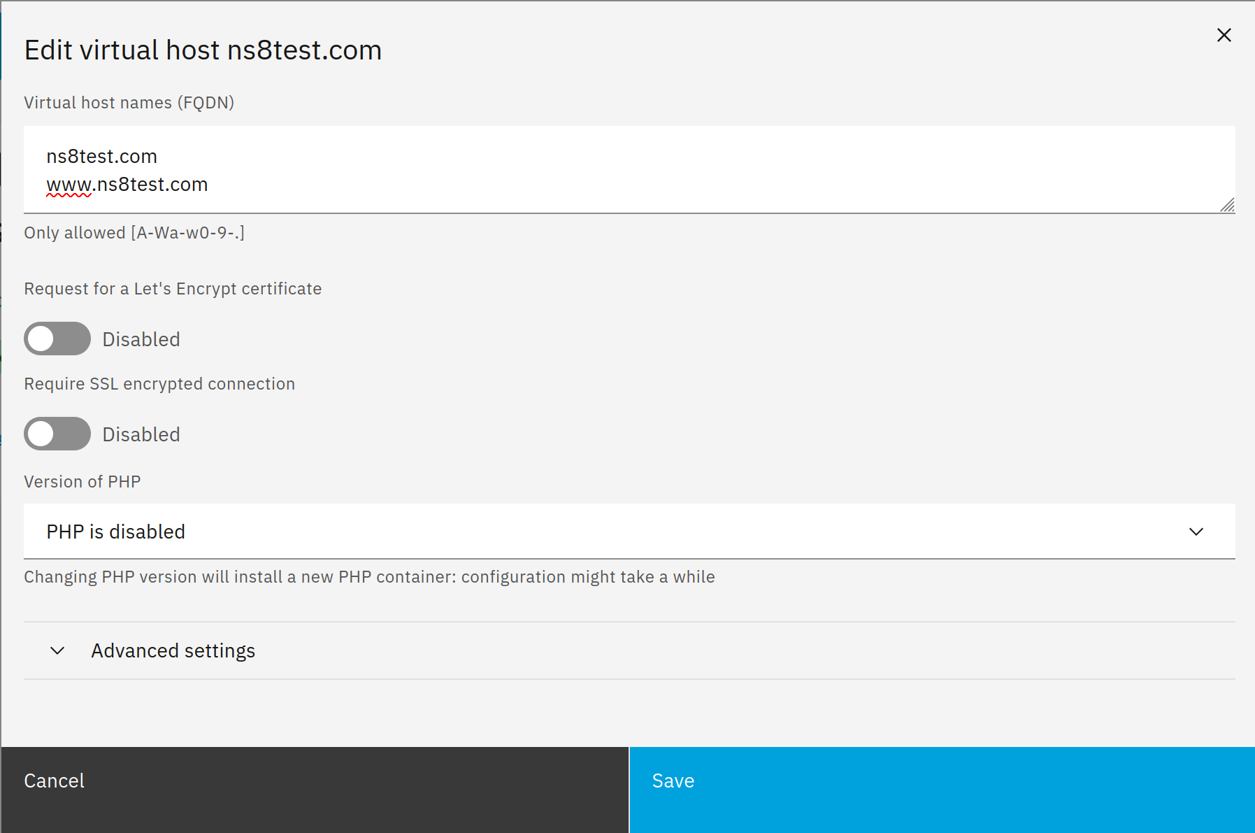

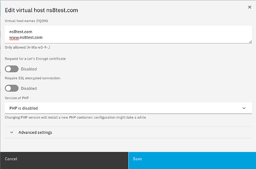

When I did the set up, I read that the instructions said to use the the FQDN. So I used domain.tld just like I did in NS7.9. But I didn’t know that if that conflicts with the NS8 host, then what I did won’t work. A note in the docs would be helpful for the newbies like me. I just changed the virtualhost name to www.domain.tld and now it will work.
The second virtualhost domain was domain2.tld and that didn’t work either until I added the www.domain2.tld. Now it is also reachable from the internet.

Did you add both FQDNs, one without and one including www?
This way I could access the website at ns8test.com and www.ns8test.com and I could reach the cluster-admin at ns8test.com/cluster-admin. (ns8test.com is the NS8 domain name)
IIRC this didn’t work when I tested it the last time, maybe the traefik update made it work.

Seeing that you entered multiple FQDN was unexpected. I didn’t realize that you could do that even though it says “Virtual host names”. There aren’t any instructions to add each FQDN on a line in the Edit virtual host dialog box or in the documentation. Cool!
I just added the domain.tld to the www.domain.tld and tried to access the https://domain.tld from outside my network. Unfortunately it didn’t work. Instead of going to the webpage it ended up at my OPNSense router. So my suspicion is that it isn’t getting forwarded from my router but I’ll have to check. It is weird that the www.domain.tld works but the other doesn’t.

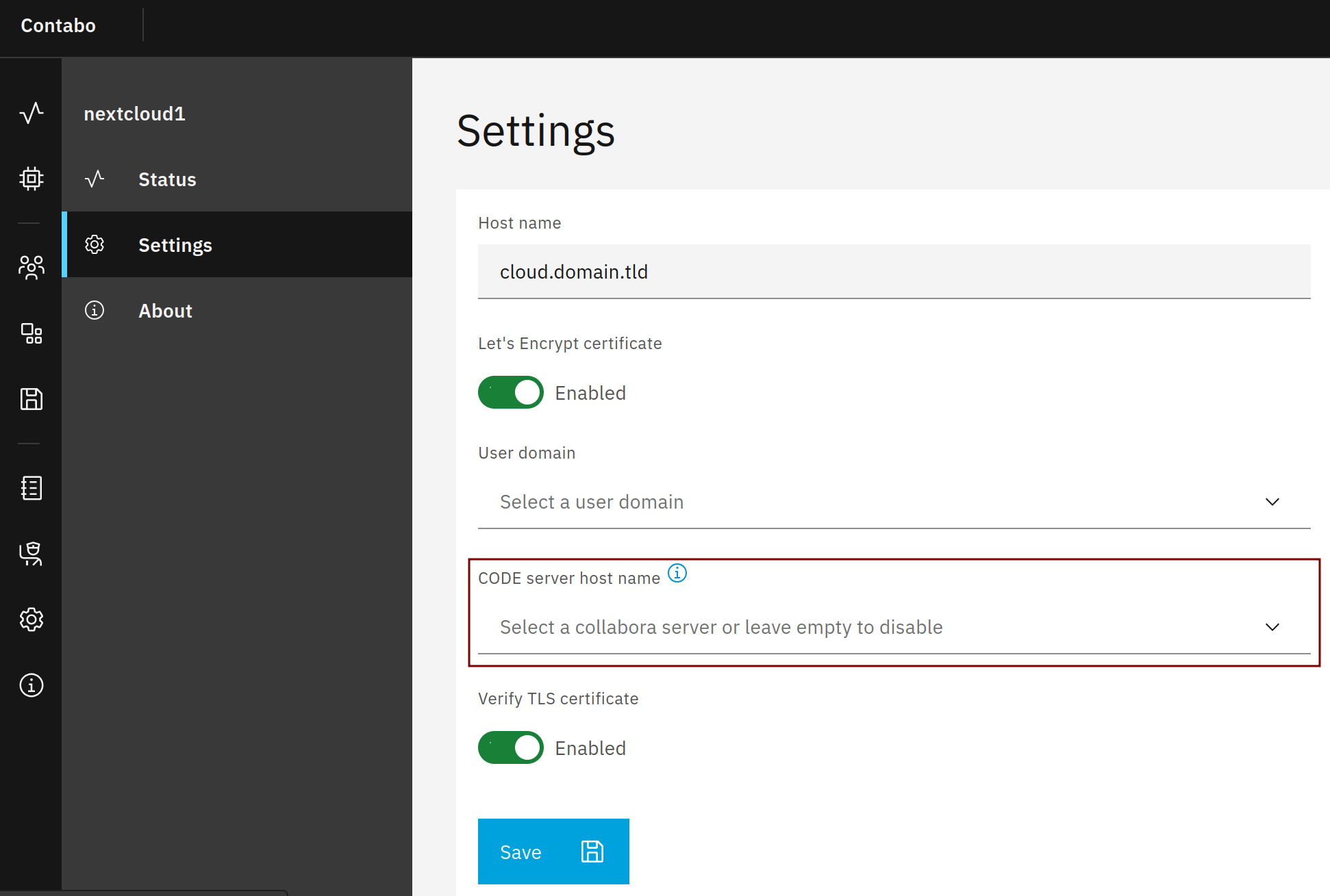

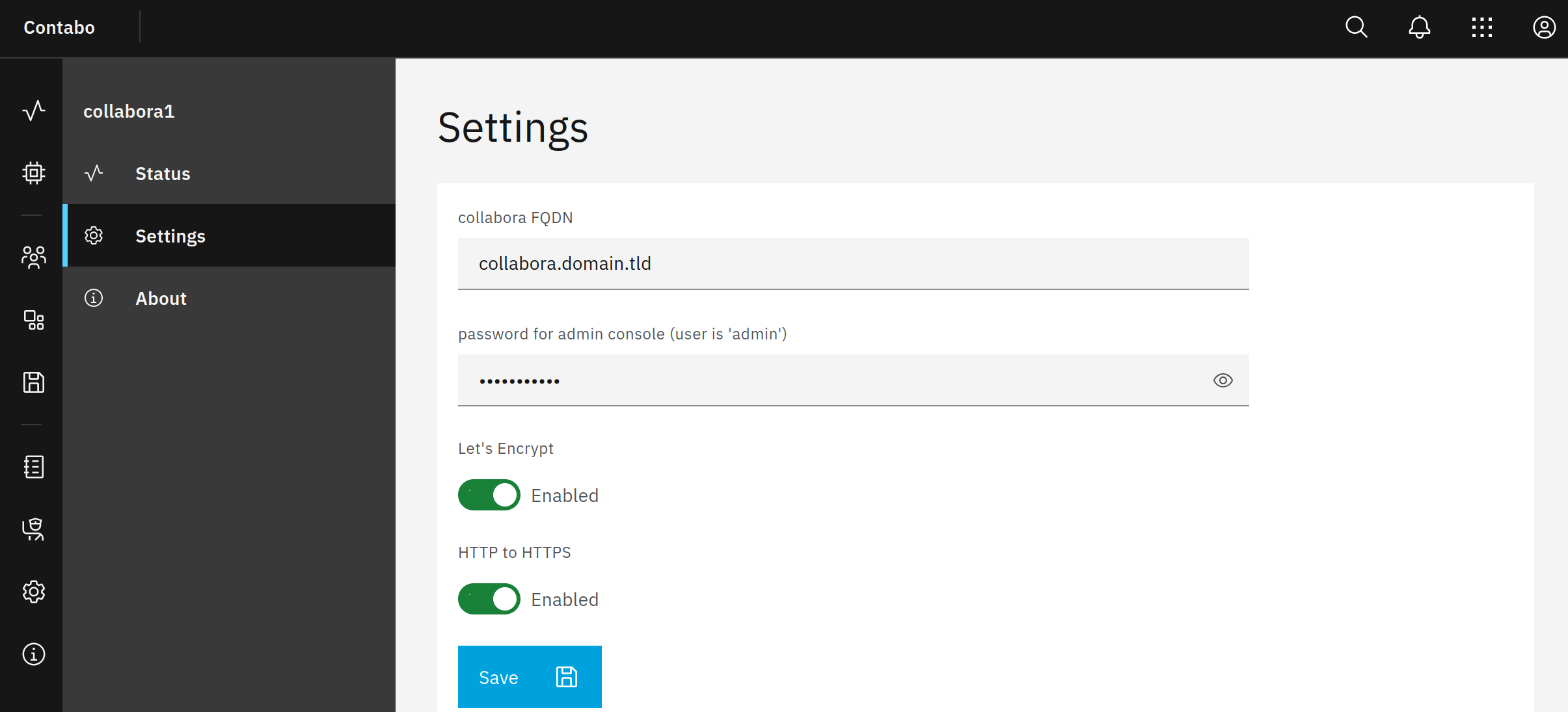

Maybe it helps to save the NS8 Collabora settings to reapply the config.

@mrmarkuz , I don’t understand what you mean. Is this settings in the NextCloud Collabora app or the separate Collabora docker container?
It’s about the app settings In the cluster admin:
Please also check the Nextcloud app settings, if the collabora server is selected:
Thanks @mrmarkuz .
I was able to get Collabra to start up and edit documents in NextCloud!!! So that has been solved also. Again, thanks for your help.
