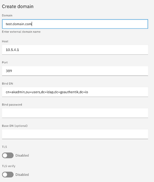

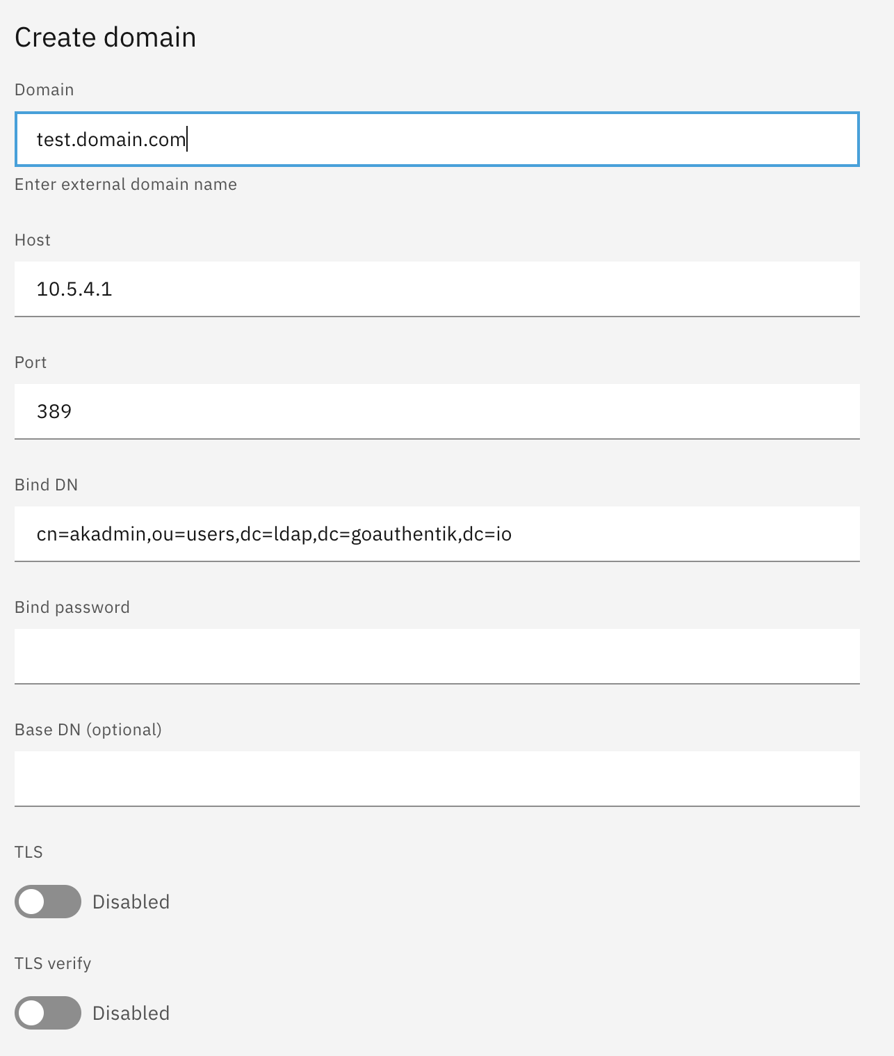

I would like to test by adding a external provider in NS8 pointing to the internal LDAP server within Authentik.

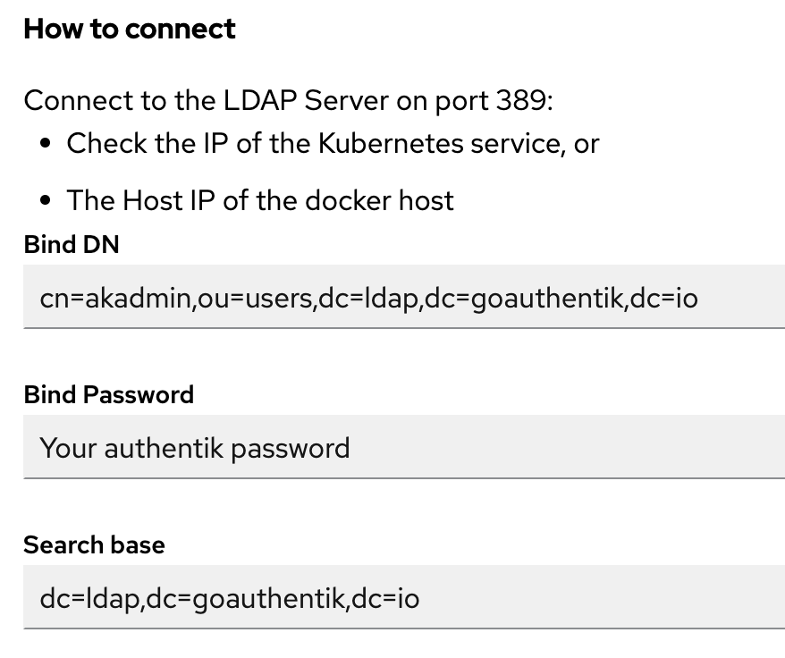

Within Authentik see:
Application → Providers → Create → LDAP Provider

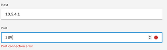

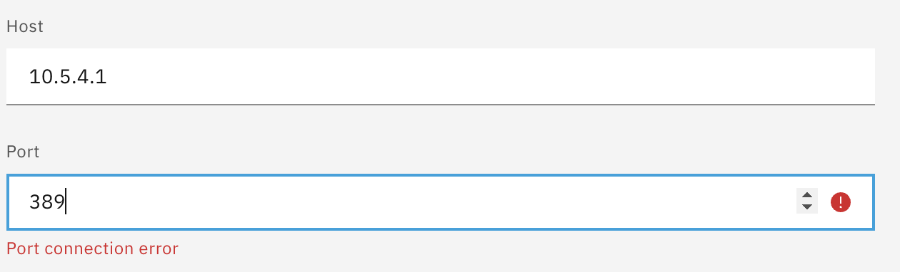

What would be the host IP and the correct port number when trying to create an extrnal account provider on NS8?
Authentik says use port 389 on the docker host IP
but I think that will not work and maybe they really mean container and port, but is what port and how to handle many LDAP provider bound to applications in Authentik??
I have not completely enabled Ldap server on Authentik, i think there are some parametersi need to define, for the port and many other details to get Ldap on Authentik towork.
you can try though
I think so too, especially how a Authentik container is designed to work and how ports and network is being handled, especially since 1 Authentik instance can act with may auth mechanisms for many application on a 1 on 1 relationship.
I completely lack the skills for diving into those docker related topics, and I appreciate your (team) efforts!
