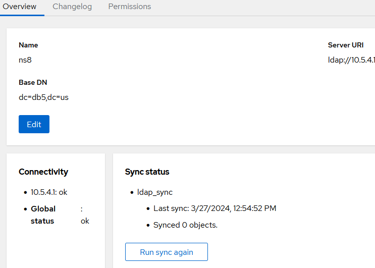

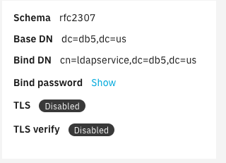

…and I don’t think anything needs to be done to allow Authentik to make the network connection; it appears to be saying that connection is fine:

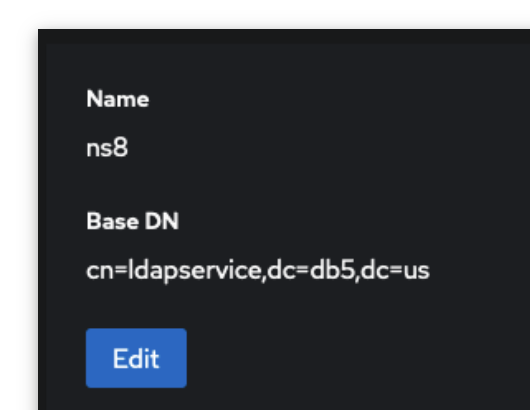

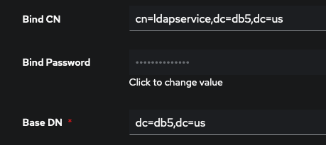

But on your previous screenshot your Base DN is the other way around with Bind DN or is that a weird display or error from Authentik?
Ah, you’re right–I’d corrected that in the text of my post, but not in the screen shot. The more recent screen shot (posted this morning) is how it’s set now.

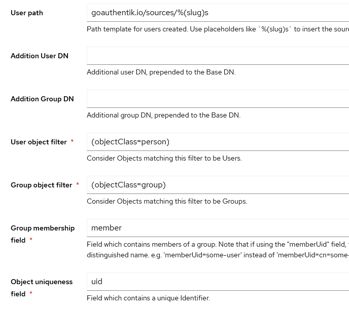

Ok, I think I got ldap sync (partially) working (once carefully reading :wink: )
In authenik:
  • One needs to use the IP number and port of the provider detail, in my case: ldap://10.5.4.1:20088
  • Correct bind and base DN
  • DE-select sync groups option (for now)
  • Under advanced ldap setting: Object uniqueness field: uid
I can now sync and get the NS8 users in Authentik. Hopefully it is a good start to explore further like correct mappings, groups and other functionality.

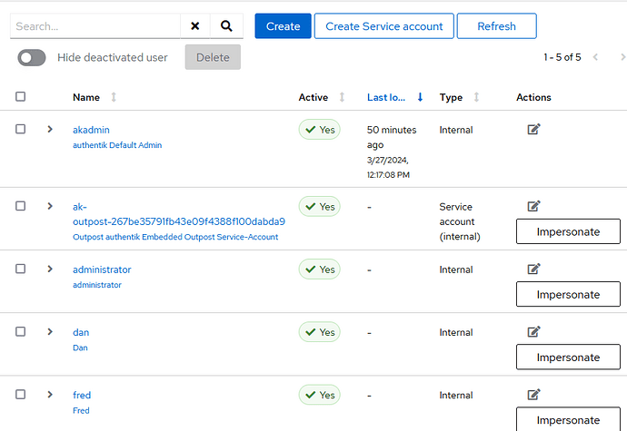

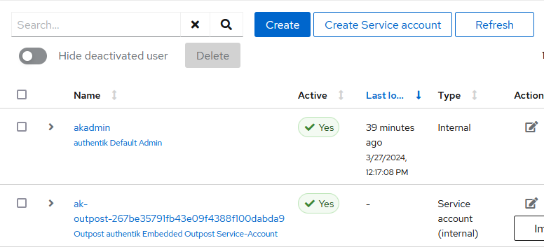

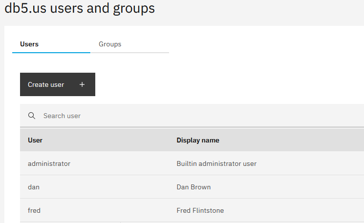

Following those instructions, I can now sync, but I don’t see any of the NS8 users in Authentik. Here are the NS8 users:
Here are the users in Authentik:
Here’s the status of the LDAP provider in Authentik:
…and settings:

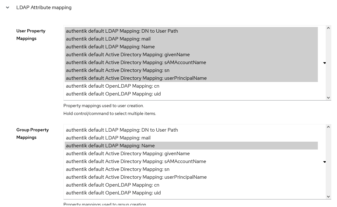

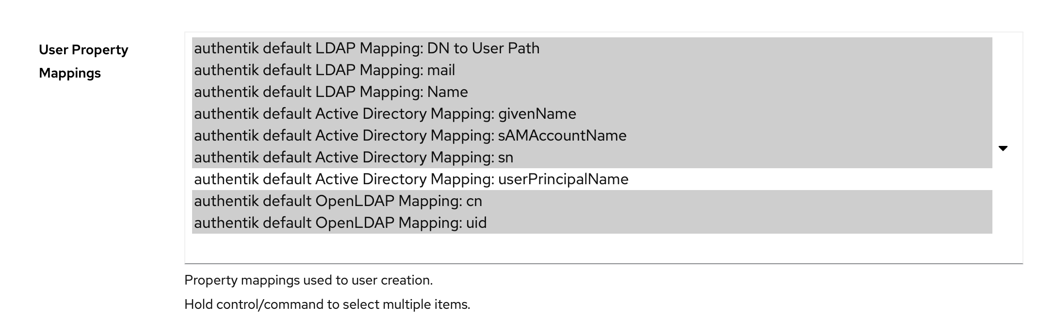

How about the regular mapping settings?
I haven’t touched them from their defaults:
Please also select cn and uid on user properties, save and sync again
Ah ha!
Top!!
