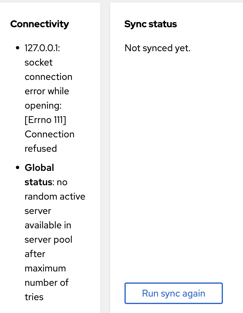

What ldap URI to use?

try with 127 if it doesnt work, we use the special ip
Did you perhaps switched the base and the bind values?

Yes, saw your message. I cannot enter ldap://10.5.4.1:20088 as a valid URI entry.

my domain ldap URI is considered invalid, so how did you get that ldap URI accepted?
Answer: Authentik caches values. One must go back to the left menu, refresh by choosing another option and then go back to ldap. Now it acceptes 10.5.4.1:20088. And also stuck with the same symptoms @dan experiences.
