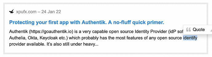

In the link provided by @LayLow:
Authentik (https://goauthentik.io) is a very capable open source Identity Provider (idP software like Authelia, Okta, Keycloak etc.) which probably has the most features of any open source identify provider available. It’s also still under heavy development with stable releases being made every few weeks.
But it seems strange that you haven’t read it!

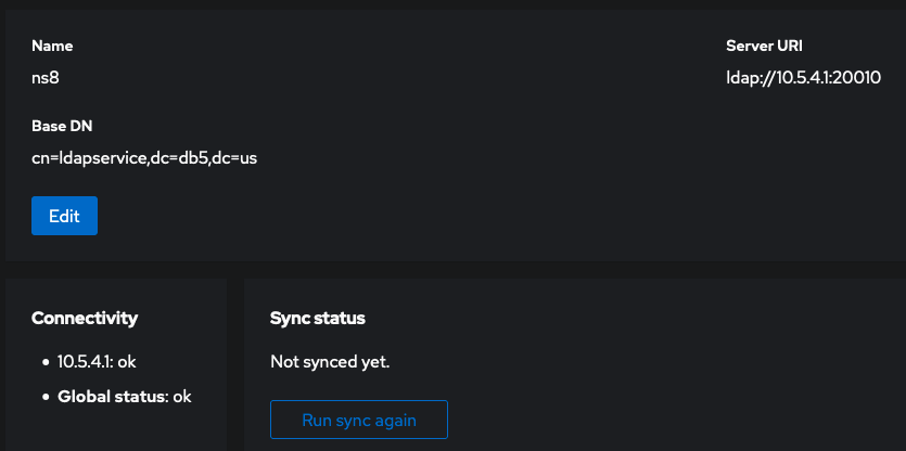

So, with that path to the setup page, here are the settings I used:
  • Name and Slug: at your discretion
  • Server URI: ldap://10.5.4.1:20010 - The IP and port are found on the domain configuration page; I don’t know how likely they are to be different for your installation
  • Disable StartTLS
  • Bind CN: set to “Bind DN” from the domain config page
  • Bind password: from the domain config page
  • Base DN: from the domain config page
This doesn’t give me any errors, but I’m not certain it’s working as expected. Here’s what I see on the status page:
Clicking “Run sync again” turns that button green for a moment, then it goes back to blue.
It’s not. I did the same with the internal VPN address, FQDN, 127.0.0.1, LDAP and LDAPS, Node LDAP port etc. but no luck. You can tell by going to the objects tab in your screenshot above and you will only find Athentik admin and no users. The app log of Authentik, The clusetr log and the node log did not give me any clues.
I guess the big question is how an LDAP instance ca be used as an LDAP resource for external apps…
I’ve updated my post; the settings for Bind CN and Base DN have changed. But I can’t see that they’ve made a change in what’s happening.
