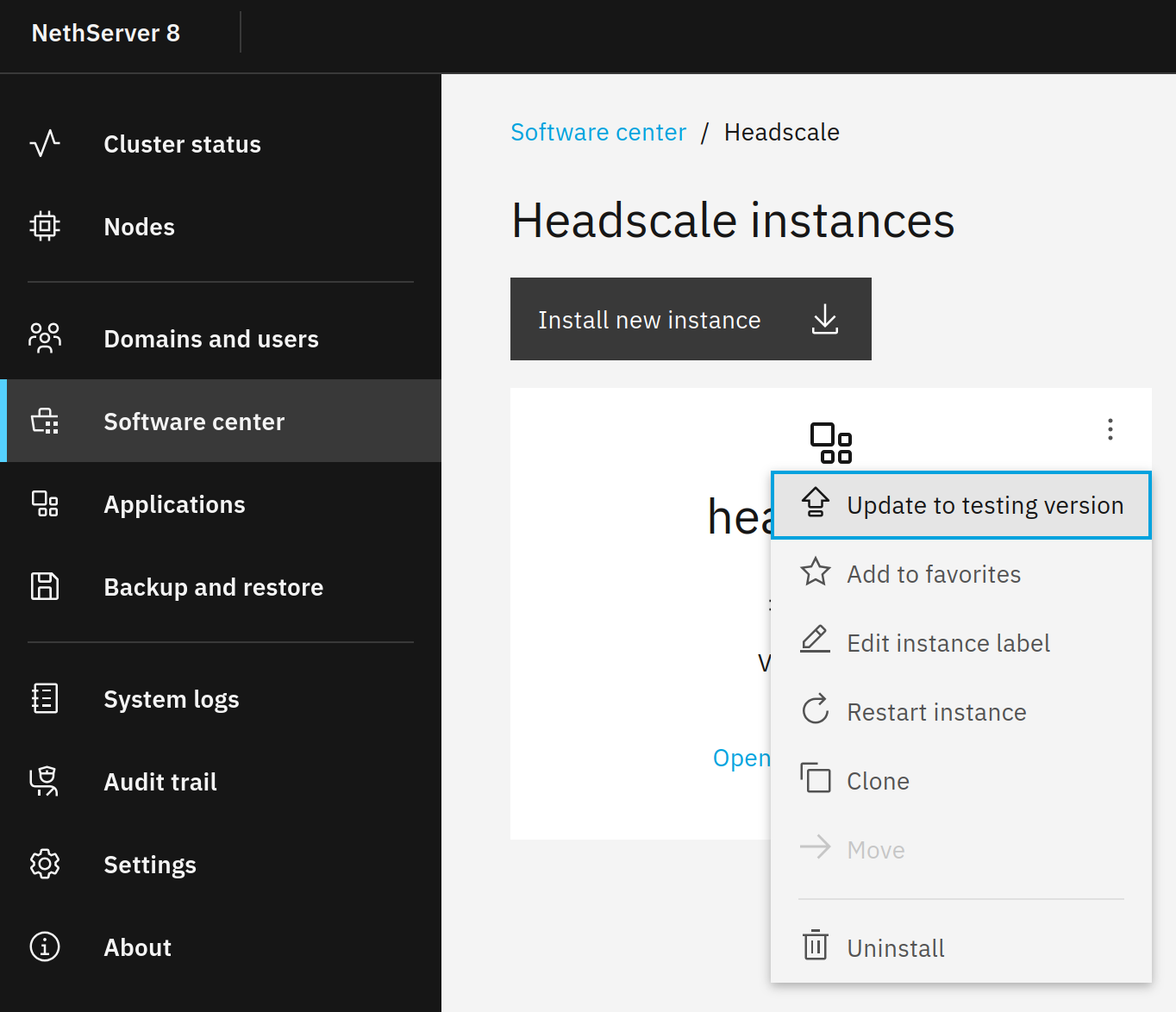

Well, that’s interesting. Thinking a reboot might help (bad Windows habits), I rebooted the NS8 server. After I did, Tailscale was no longer logged in. tailscale login --login-server <foo> returned a URL to connect; when I browsed to that URL, it did not use the OIDC authentication.
The settings for the headscale app hadn’t changed, but I re-saved them. After I did that, I re-ran the tailscale login command, it returned a different registration URL, and browsing there allowed me to log in via OIDC.
Moreover, once I did that, whatever firewall issue I was having appeared to be resolved:

The upgrade to headplane still isn’t working yet so I released an update including Headscale 0.28 and headscale-ui 2026.03.17.
Please care about having a backup in case something goes wrong.
Upgrade to testing from UI:
Upgrade via CLI:
api-cli run update-module --data '{"module_url":"ghcr.io/mrmarkuz/headscale:1.0.5-dev.1","instances":["headscale1"]}'
Fresh installation:
add-module ghcr.io/mrmarkuz/headscale:1.0.5-dev.1
Thanks in advance for testing!

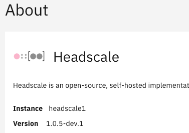

Output:
Seems to have installed OK:
I don’t know what more to test, but it all seems to be working so far.
