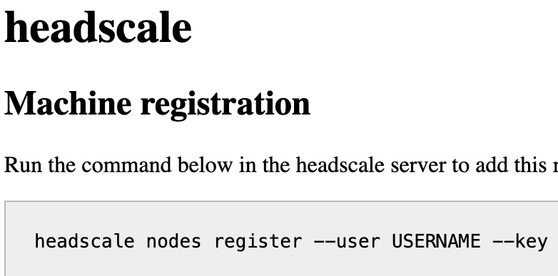

I noticed that the config on the docs page had quotes around the URL, client id, and client secret, so I added them. No change–when I go to Tailscale on my client computer and add a new account on the new server, it immediately sends me to this web page:
I don’t see anything obviously wrong in the config, but I haven’t used it with Headscale before.
I don’t think I’d changed anything else in my current production Headscale server.

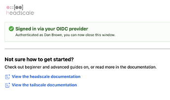

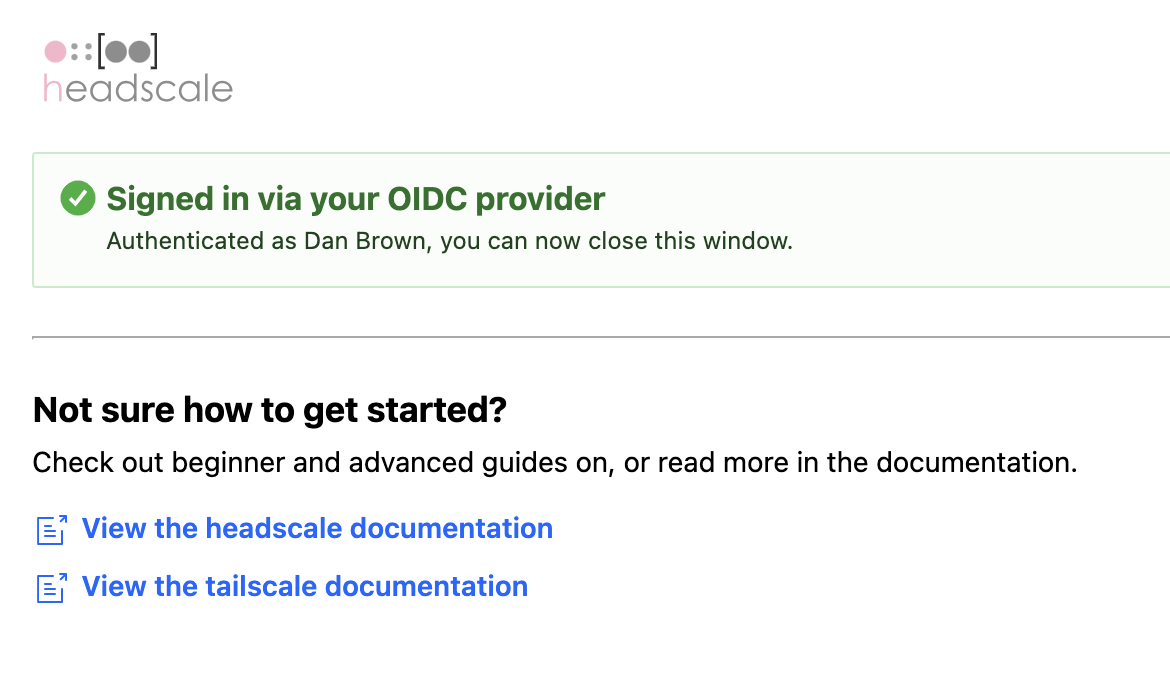

That seems to have done the trick. I’m already signed in to Authentik on this browser, so when I went to add the account to Tailscale, it showed me this page:
…and I’m good to go.
Great, so OIDC is working! In the next update the network option will be included.
