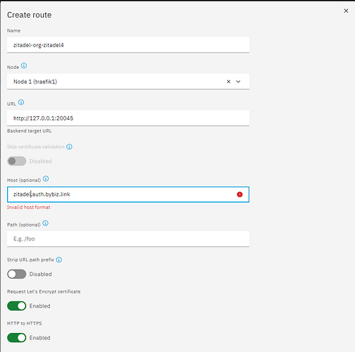

Locate Zitadel Http Routes in settings
Create Wildcard http Routes, Defind by your Wildcard Domain defined for zitadel
IN my Tests it was impossble to define a wildcard route
SO i defined the First Available orgName
