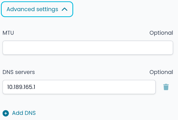

The Wireguard clients access the DNS server at the IP of the firewalls Wireguard network interface.
In this example if you add a Wireguard server tunnel with the filled in DNS server:
The Nethsecurity creates a Wireguard private network:

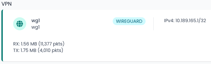

The problem is in the automatically generated server’s IP address of the Wireguard network, OpenWRT expects an address in CIDR format (otherwise it is resolved as /32? or I’m wrong?)
Change it to list addresses ‘w.x.y.z/24‘ adding /24 where w.x.y.z is the original address

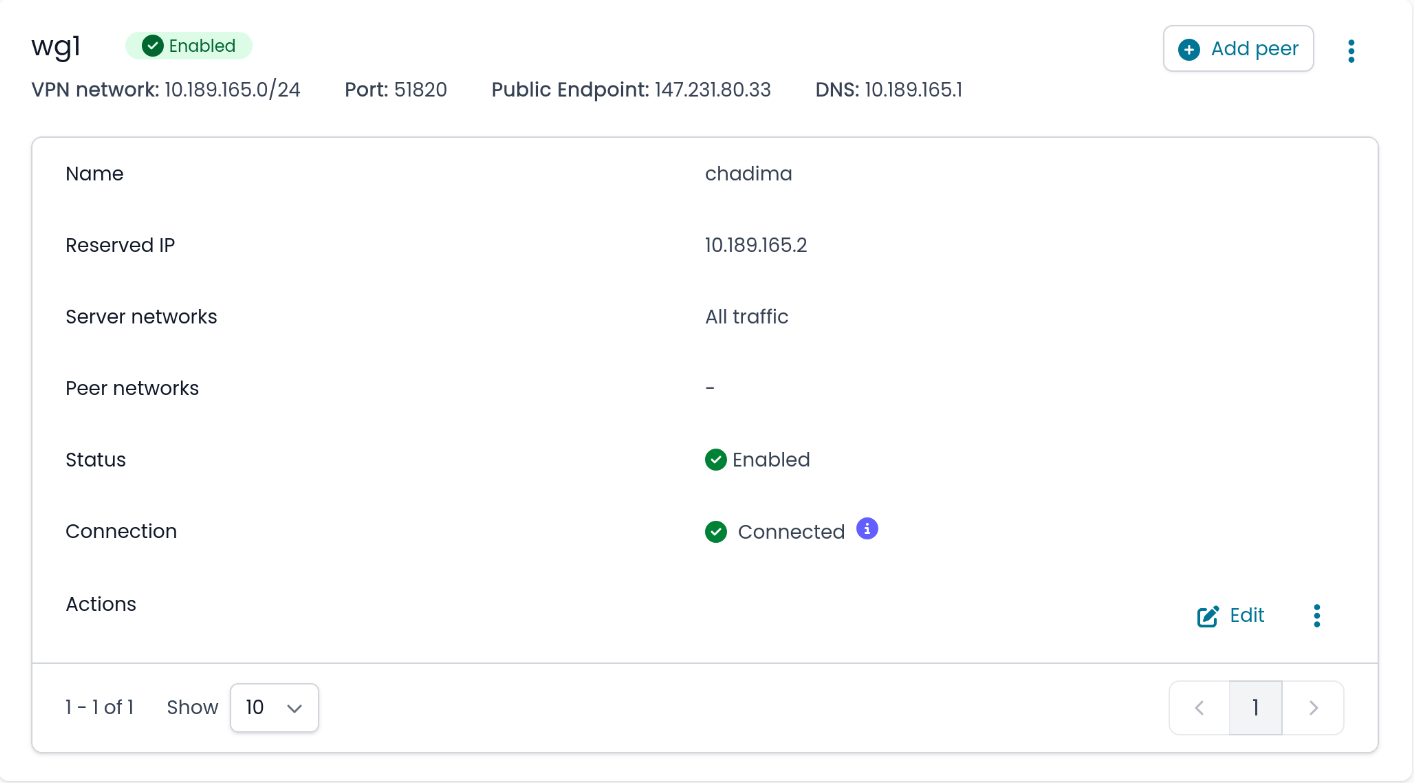

Hello antonin!
Could you share the export of a .conf of a peer with the keys removed?
The addresses section should be fine, since it gets automatically converted to a /32 as you pointed out, but the impossibility of the connection could be a misconfig generated by the client config
following the guides and documentation of Wireguard on OpenWRT, list addresses
should be a CIDR notification of the IP and whole network → this a clear NethSecurity bug…
The server doesn’t know how to route/send packets to the client (the client IP is not in the same network…)
