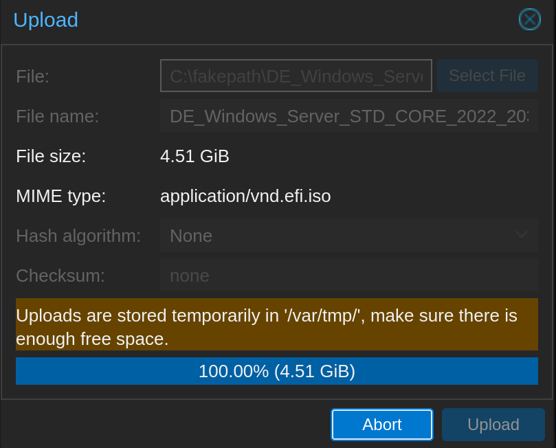

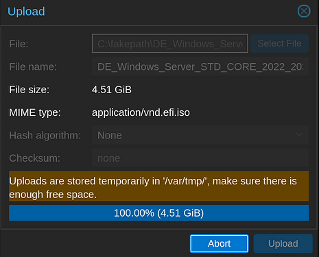

I tried to reproduce the issue with my proxmox cluster and files bigger than 4GB can’t be uploaded through the UI. Uploading the same ISO file without traefik proxy in between works.
It’s stuck at 100%:
The browser console shows:
Uncaught Error: You're trying to decode an invalid JSON String: Gateway Timeout

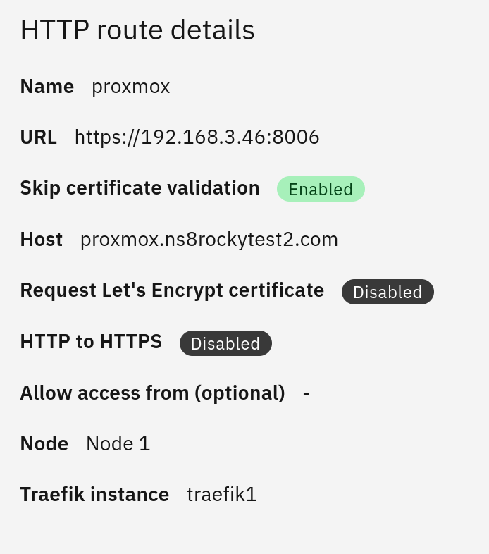

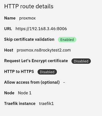

This is my HTTP route config:
I’m going to investigate further but there seem to be issues with big file uploads. (maybe related to multi-node clusters)

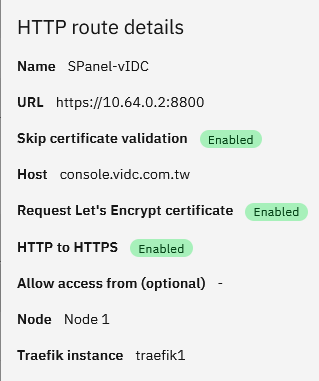

You can log in and upload a file for testing.

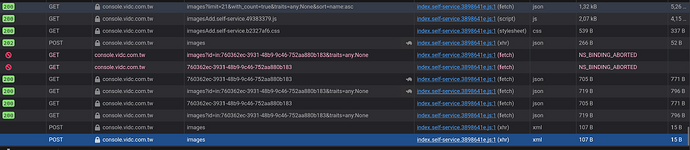

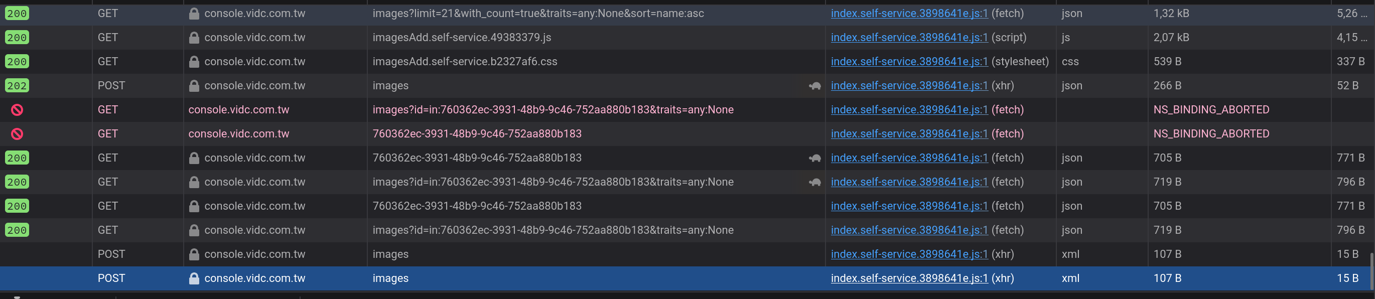

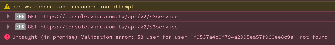

I could reproduce, a small ISO is working but a larger one doesn’t.
There’s also an error about the S3 storage but I don’t know if it’s relevant for the issue:
