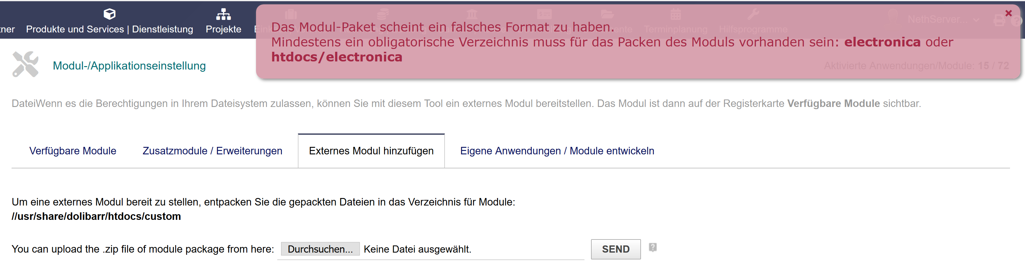

Got some issues with Module/Plugins…
Tried to import external modules:
  1. Colombian electronic invoice 11.0.x
  2. TakePOS 8 (with Odoo theme)
same problem here. To activate the internal Moduls like Projectmanagement an others is possible.
But install external modules ends with the message posted by fpausp.
Greetings…
Uwe
the good version now is 0.0.6 and 11.0.3-2, check them
well sorry I do not speak germain (I suppose).
  1. be sure you have updated to the last version : yum update --enablerepo=stephdl-dolibarr
  2. Colombian electronic invoice 11.0.x seem not compatible like you can read (however I am not really a dolibarr expert)
    The module package seems to have a wrong format.
    At least one mandatory directory must exists into zip of module: electronica or htdocs/electronica
if you need it maybe you can follow the manual instruction
Download the archive folder (.zip) from dolistore.com
Unzip the archive in the directory /htdocs/custom of your dolibarr.
Module can then be enabled (), set up () if necessary from the setting page and then run.
  1. TakePOS 8 (with Odoo theme) is already installed, search by TakePOS in the module, however I needed to increase the php maxupload size inside dolibarr to upload that file

@stephdl it means
File is too big
Wrong format of module-packet
Minimum one folder has to be there to pack the module
cc @fausp
@fausp in the security module you can increase the size of php file, also with the command line and esmith property

That’s why taking screenshot in english is better for publishing to the community.
