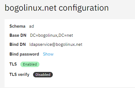

I’m trying to get TrueNAS-Scale to use the NS8 AD. My initial attempt at connection, once I worked out what the correct Bind DN parameter was (Hint, it’s not what you show on the Configuration page)
This failed with:
middlewared.service_exception.ValidationErrors: [EINVAL] ldap_update: [STRONG_AUTH_REQUIRED]: Strong(er) authentication required: BindSimple: Transport encryption required.
So looking at the addition parameters available, it looked like I had to turn on TLS for the connection, so I tried to generate a certificate for the CN used by the AD. This failed with:
{“context”:{“action”:“set-certificate”,“data”:{“fqdn”:“NSDC-NETHSERVER.bogolinux.net”,“sync”:true},“extra”:{“description”:“Processing”,“eventId”:“24172678-dc7a-4a4d-a2b9-af59f9907fe0”,“logs”:{“instance”:“traefik1”,“path”:“?searchQuery=&context=module&selectedAppId=traefik1&followLogs=false&startDate=2024-08-19&startTime=10%3A37&autoStartSearch=true”},“title”:“Request certificate for NSDC-NETHSERVER.bogolinux.net”},“id”:“73d2ae8f-6bc1-429b-89ac-e372fe79fa94”,“parent”:“”,“queue”:“module/traefik1/tasks”,“timestamp”:“2024-08-19T17:37:34.267038547Z”,“user”:“admin”},“status”:“aborted”,“progress”:99,“subTasks”:,“validated”:true,“result”:{“error”:“”,“exit_code”:2,“file”:“task/module/traefik1/73d2ae8f-6bc1-429b-89ac-e372fe79fa94”,“output”:{“obtained”:false}}}
Looking through the traefik1 logs I couldn’t see anything obvious that was wrong and it was only at the 99% stage of the process that it appeared to fail.
I’ve got the DNS entries set up both internally and externally set up correctly to find the server, so not sure why one request would work, but not another.
Cheers.

One difference I did notice is the specification of the Bind DN parameter. NS8 shows it as an email address:
Where TrueNAS is expecting this:
It wouldn’t let me put the email format in.

The correct bind DN should be something like:
CN=ldapservice,CN=Users,DC=bogolinux,DC=net
or
CN=ldapservice,DC=bogolinux,DC=net
If nothing else works, It’s also possible to disable the need for strong auth but it’s not recommended because of the weak security:
Add the following to your /home/samba1/.local/share/containers/storage/volumes/config/_data/include.conf and restart the samba-dc service:
ldap server require strong auth = no
