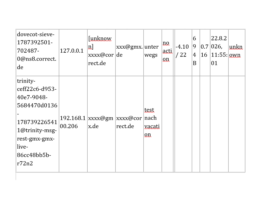

Sogo vacation emails are not sent/received
the vacation thing turn me nuts.Now it works, but only on the inside of the Mail System. If someone from inside the network—say, a coworker—sends a message, the auto-reply works; if someone from outside sends a message, there’s no out-of-office message. Since I’ve already made such a mess of things with the other one, what do I need to keep in mind to solve this problem?
inspect the log of the mail module to watch if a mail has been sent, the email is sent only once but it can be bounced by the remote smtp
I have no idea what i need as information to explain my Problem. This is a try from outside the Server to send a vacation respond, how you can see the system said, it send the message, but it doesent work, i also check spam etc.

Here, from inside the Server, from Co Worker it send the autoresponding message
4.10/22.00] [REPLY(-4.00){},MIME_GOOD(-0.10){text/plain;},ARC_NA(0.00){},DKIM_SIGNED(0.00){localmailserver.de:s=default;},FROM_NO_DN(0.00){},MID_RHS_MATCH_FROMTLD(0.00){},MIME_TRACE(0.00){0:+;},MISSING_XM_UA(0.00){},PRECEDENCE_BULK(0.00){},RCPT_COUNT_ONE(0.00){1;},RCVD_COUNT_ZERO(0.00){0;},SINGLE_SHORT_PART(0.00){},TO_DN_ALL(0.00){},TO_DOM_EQ_FROM_DOM(0.00){},TO_MATCH_ENVRCPT_ALL(0.00){}]), len: 559, time: 121.658ms, dns req: 9, digest: <9faab6634747f03b7ce8cd19861767aa>, rcpts: xxx@localmailserver.de, mime_rcpts: xxx@localmailserver.de

the problem is, that from the script for vacation the email adress is routed to the internal adress. and then the relay server dont allow to send it.
at least this is happening, i got an email from outside, then the vacation responding starts, but change the adress and the relay server denies the transport
Found it — thanks for the doveconf output, it confirms the full chain.
sieve_vacation_send_from_recipient = yes is set in your config. This setting makes Dovecot use the LMTP delivery address as the vacation’s sender/from address instead of your sieve_user_email (%u@xxxxx.de) or the script’s own :from. On NS8, that delivery address is an internal address (the *.localhost domain you’re seeing), not your real domain - and that’s exactly why the relay then refuses to send it out: it’s not a valid outbound sender.
sieve_user_email is already correctly set to your real address, so the fix should be to remove sieve_vacation_send_from_recipient = yes from your Dovecot custom config. Once removed, the vacation reply should use your real address again instead of the internal one.
Could you let us know which file you added that setting in, so we can confirm exactly what to change? After removing it, please test again from outside and let us know if the vacation reply reaches gmx.de correctly.
i did not get it done, i tried everything but the vacation respond is always with an empty sender mail and so the relay server denied it. u see it down in the first row from=<> it is empty
in Rspamd it looks like:
[unknown] correct@adress.de
2026-08-23T13:25:08+02:00 [1:mail1:postfix/qmgr] 08AD222146BA: from=<>, size=788, nrcpt=2 (queue active) … 2026-08-23T13:25:08+02:00 [1:mail1:postfix/smtp] Untrusted TLS connection established to smtp.xxxxx.de[213.165.67.113]:587: TLSv1.3 with cipher TLS_AES_256_GCM_SHA384 (256/256 bits) key-exchange X25519 server-signature RSA-PSS (3072 bits) server-digest SHA256 2026-08-23T13:25:08+02:00 [1:mail1:postfix/smtp] 08AD222146BA: to=xx@xxxxxx.de, relay=smtp.ionos.de[213.165.67.113]:587, delay=0.89, delays=0.48/0.01/0.37/0.02, dsn=5.0.0, status=bounced (host smtp.xxxx.de[213.165.67.113] said: 550-Requested action not taken: mailbox unavailable 550-Sender address is not allowed. 550 1McY4R-1wNw9z0kij-00nigR (in reply to MAIL FROM command))
