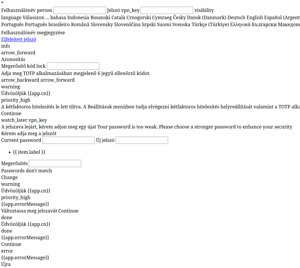

An update has arrived for the NS8 SOGo module. I installed the update version 2.2.0 and since then the SOGo page looks like the image below. What is the reason for this and how can I fix it? Clearing the browser cache does not help…
Thank you for help

I can’t reproduce. Did you customize SOGo like adapting the logo or background?
It looks like the CSS is completely missing.
Does it work in another browser?
Are there errors in the browser console ?

I changed nothing.
It doesn’t work with Firefox, Chrome, or Konqueror.

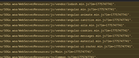

The failed to load with this resource:
I don’t know what this means… There hasn’t been a problem with this so far…

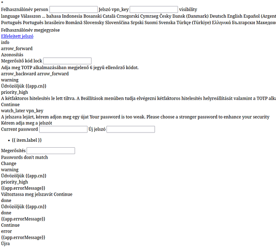

5
I tried it, but the same error.
