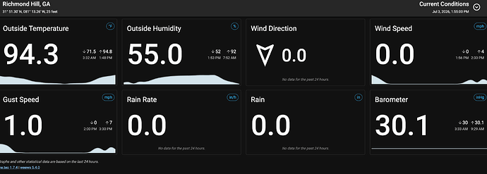

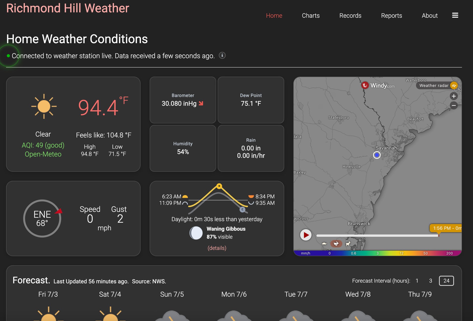

  • WeeWx - my previous understanding that it only generates static pages wasn’t quite correct. On the simple side, there are a number of themes (or “skins”) that include JS to reload the page on an interval, so it updates every (say) five minutes. On the less-simple side, one skin includes the capability of connecting to a MQTT broker for live updates as often as they’re published (every 1-2 seconds in my case).
  • others? I’m still not aware of other real options here.
I don’t need to make a move immediately–even if it’s discontinued, it’s not like Meteotemplate just stops working. But it’s obviously time to find another solution, and it’s looking like that’s going to be using WeeWx. Here’s what I’ve done so far:
  • Moved the MariaDB database from my NS8 instance to the VM running WeeWx
    • I honestly don’t know (or remember) why I was running this database remotely from WeeWx. Meteotemplate didn’t use it directly; maybe I thought it did? In any event, it’s not running there any more.
  • Installed two skins: Me.teo to act as a weather console on a spare tablet, and New Belchertown for the main site.
  • Done a fair bit of messing about on the WeeWx system as discussed here: https://groups.google.com/g/weewx-user/c/kXgtN8QWYLk
But the result is that it’s working pretty well so far. Screen shots:
What’s left is to get this data onto a public webserver. WeeWx’ rsync capability should be able to update my NS8 virtualhost to accomplish that, I’d think.
