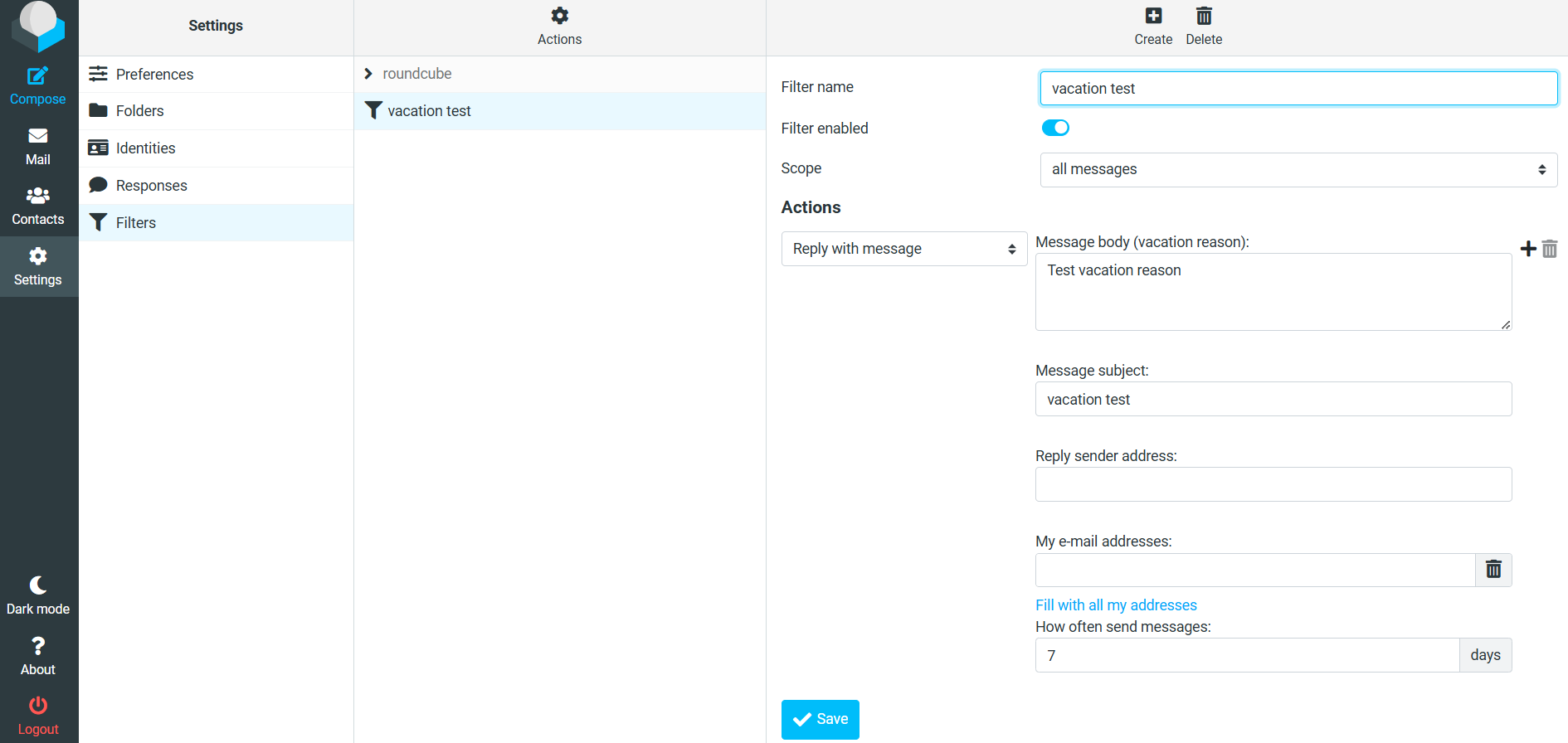

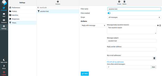

Help me set up an auto-reply.
If I set it up through a filter, the auto-reply doesn’t come. :frowning:
The filter looks correct.

How did you test the autoreply?
Did you send an internal mail?
Did you send a mail from external without using imapsync?
Do you see that the filter is triggered in the logs?
I send a mail from external without using imapsync. The reply with the letter “Test vacation reason” is not received.

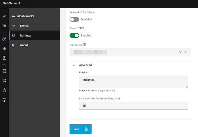

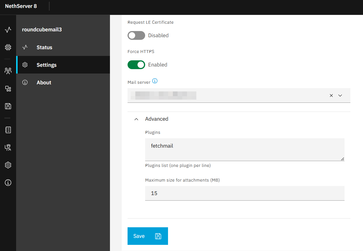

2025-06-03T14:40:09+03:00 [15:roundcubemail3:roundcubemail-app] errors: PHP Error: Failed to load plugin file /var/www/html/plugins/fetchmail/fetchmail.php in /var/www/html/program/lib/Roundcube/rcube_plugin_api.php on line 193 (POST /?_task=settings&_action=plugin.managesieve-save)
2025-06-03T14:40:10+03:00 [15:roundcubemail3:roundcubemail-app] 10.0.2.100 - - [03/Jun/2025:11:40:09 +0000] "POST / HTTP/1.1" 200 6291 "https://webmail.domain.com/" "Mozilla/5.0 (Windows NT 10.0; Win64; x64) AppleWebKit/537.36 (KHTML, like Gecko) Chrome/134.0.0.0 Safari/537.36"
Did you install a fetchmail plugin? It seems not working, please try to remove it.
Thanks. I completely forgot…
