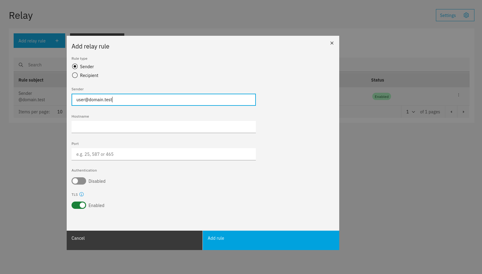

As alternative take a screenshot of the table in Mail Relay page.
Replace “mail1” with your Mail instance ID.
Mail 1.7.0 is supposed to fix an authentication bug within Relay Rules, so try to change the password or re-create the relay rules from scratch to see if it can solve the issue.
Please make a test with a rule_subject matching the exact sender address. I see your rule wants to match the domain. I’m looking at the domain query and there can be an issue, let’s try to exclude it.

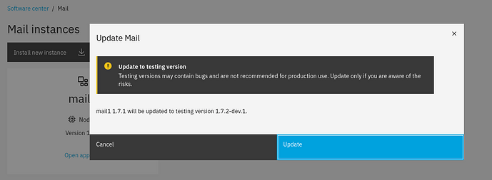

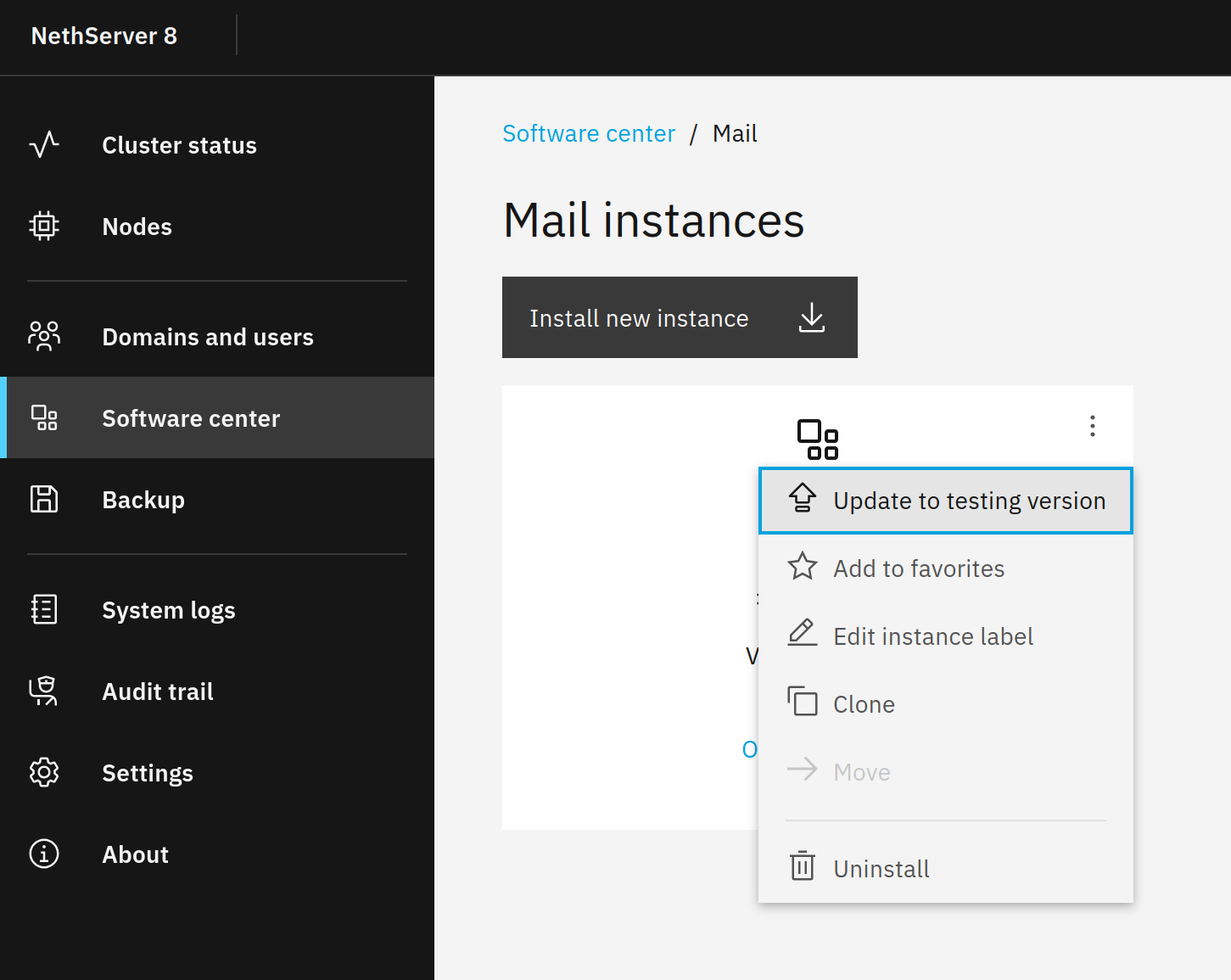

The fix is available in testing release 1.7.1-dev.2. Reload repositories from the Software Center page then you’d see the “Update to testing version” action in your Mail instance.

Since this morning version 1.7.2-dev.3 is available for testing. Existing installations can be updated using the Update to testing version action in the Software Center, as explained above.
This release addresses the relay bug and other reported issues. We already consider it a release candidate, as it is running in some production environments.
You’re invited to try it out and share your feedback. Your input will help us build confidence in this release.
