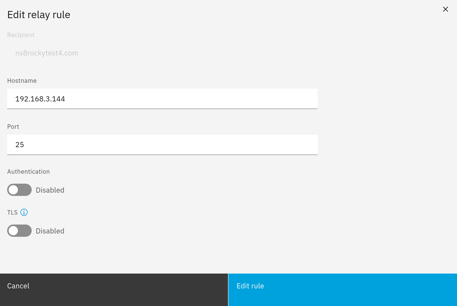

I could reproduce the relay access denied message when relaying wasn’t allowed on the internal server.
If you want to relay via port 25 without authentication to an internal server you may need to allow relay for the NS8 IP on the internal server (which in my test case also is an NS8).
If you use authentication, it should just work.
Here’s the recipient relay rule I used:
Now it’s possible to send a mail for example in Roundcube to user@ns8rockytest4.com and it’s relayed via 192.168.3.144.
