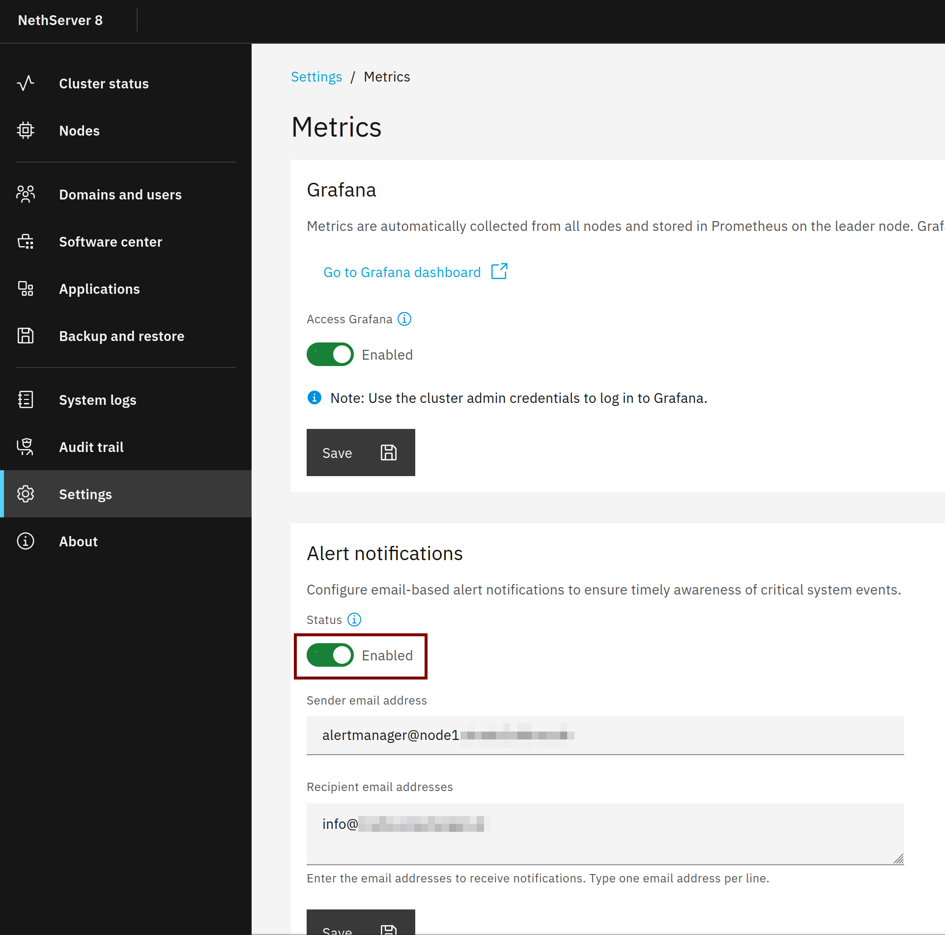

I assume that you enabled the “Alert notifications” in Settings/Metrics:
You could fire a test alert so a test alert mail should be sent which shouldn’t be blank:
