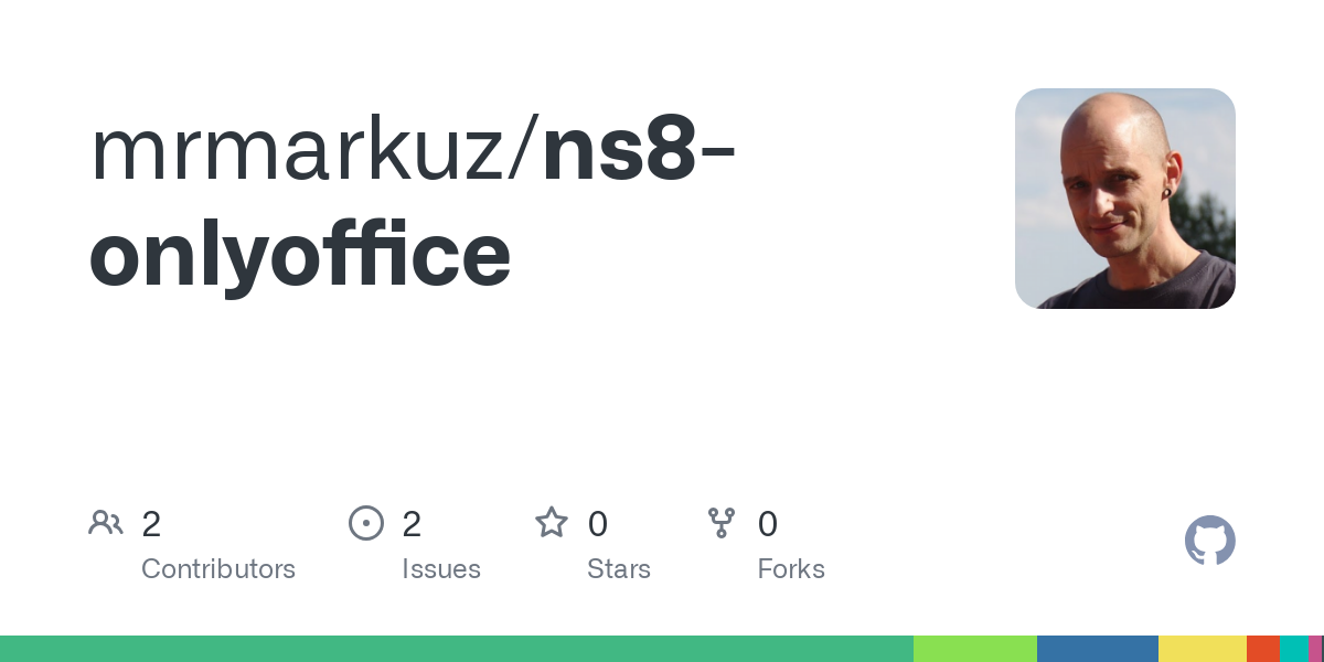

Hi guys,
I’m proud to present the new Onlyoffice app, a web document editor that works with Nextcloud.
Contribute to mrmarkuz/ns8-onlyoffice development by creating an account on GitHub.
Installation is possible using the Software Center by adding my repository, check out the repo webpage for instructions.
Installation on CLI:
add-module ghcr.io/mrmarkuz/onlyoffice:1.0.0-beta.3
After the installation go to the app settings and set a hostname.
Onlyoffice works best using a Letsenrypt certificate but it’s also possible to disable the certificate check, see documentation .
Please help testing and share your feedback and your ideas. Thanks in advance!
