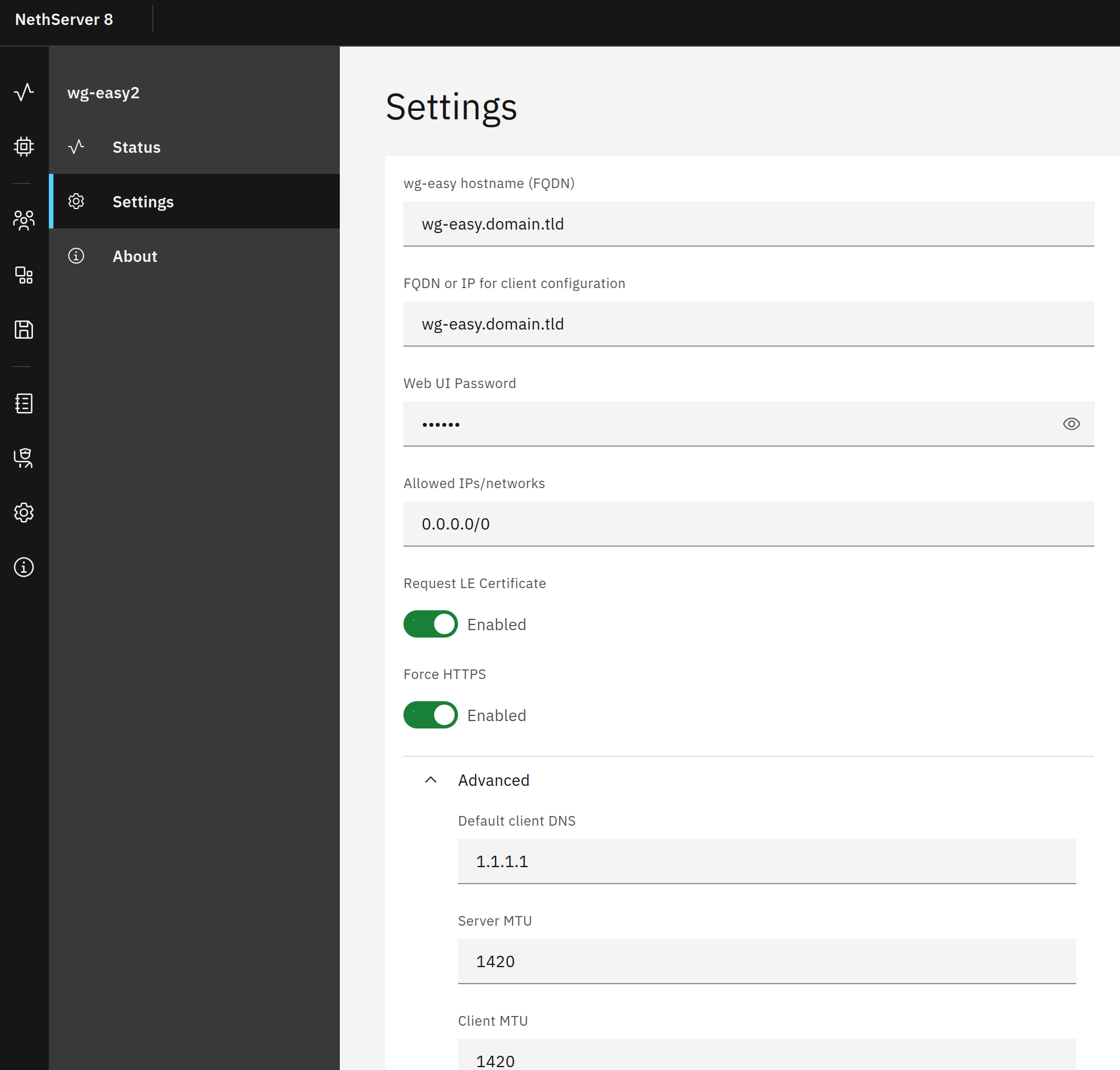

I assume you removed/masked the keys?
The endpoint should be your public IP or FQDN.
My working config looks like this:
When AllowedIPs is set to 0.0.0.0/0 the client is allowed to reach everything.
If you want to set it more restrictive you need to set at least 10.5.4.0/24 to reach the Nethserver that’s reachable by the NS8 Wireguard IP, usually 10.5.4.1, it can be found on the Nodes page.
