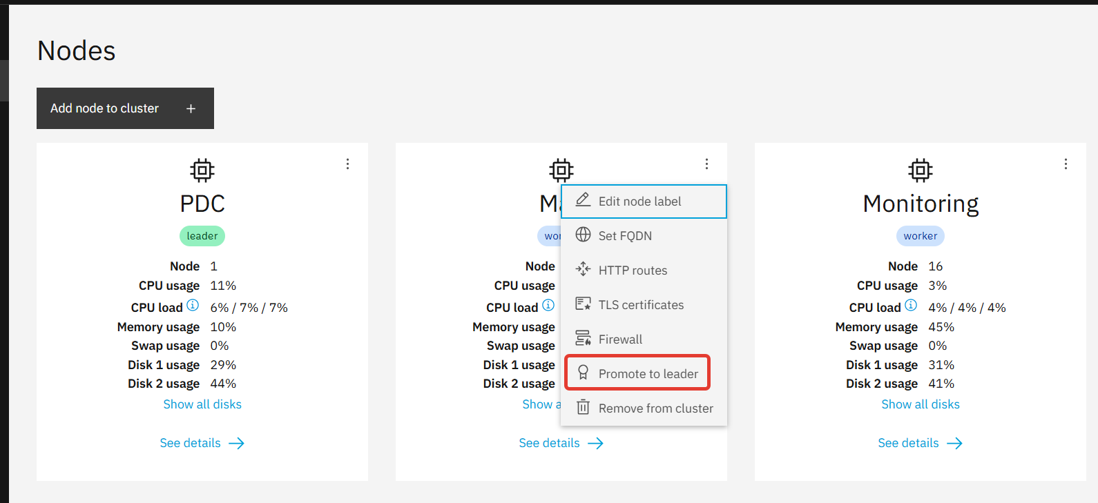

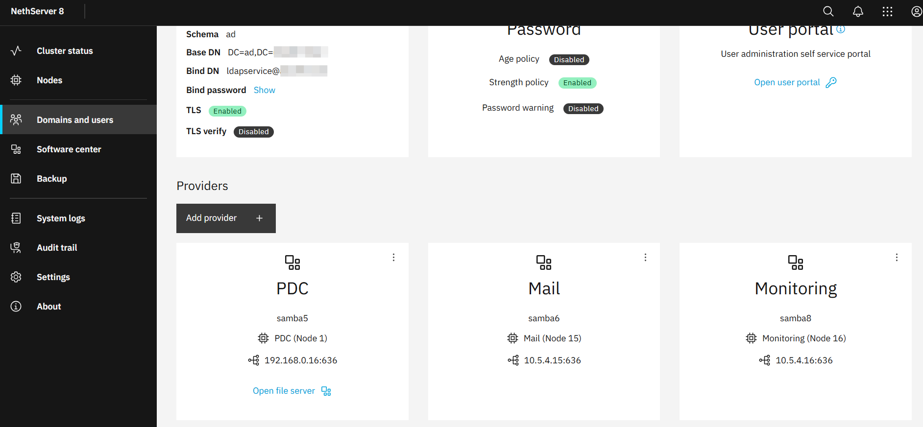

Hello! Am I correct in understanding that if an additional DC provider (node15 samba6) is installed in a cluster (Leader node1 DC samba5), then when the Leader switches to node15 (samba6), it becomes the primary DC? Accordingly, after switching the Leader to node15 (samba6), do I need to change the DNS IP in the DHCP settings for node15’s IP?
No, changing the cluster leader doesn’t change the samba configuration.
BTW, there’s no primary DC in NS8 or recent Samba, see https://wiki.samba.org/index.php/Setting_up_Samba_as_an_NT4_PDC_(Quick_Start)
There are provider replicas, which are other DCs without external access (just internal replicas), see User domains — NS8 documentation or a file server as domain member, see also Samba file server — NS8 documentation
Great. That’s what I need. I added Provider (node15 samba6). How can I continue to use the replicated DC samba6 (node15) if users can’t access samba1 (node1 Leader)?
The replicas are just listening to the internal NS8 wireguard network so the NS8 apps are using it, it doesn’t work for external clients like a PC in the network.
So, for DC samba1 fault tolerance (for users), the only option is to set up regular backups?
Sorry, there’s no fault tolerance for external devices yet.
Yes, backup is always a good idea but no real failover.
I need to test if it’s possible to set a replica to listen to the LAN IP when the samba1 instance is failing but this could be dangerous as only one samba instance listening to LAN is allowed at the moment.
