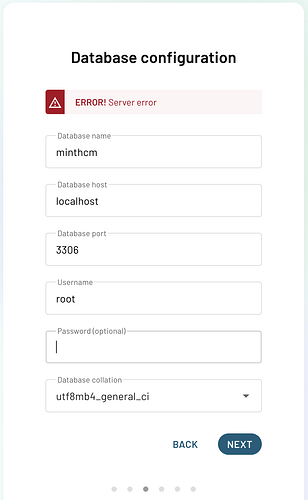

Am having issues creating the minthcm module i am getting a database error
(config.php)
Database error. Please check suitecrm.log for details.MintHCM installation completed!
who can help me out here

Also i have noticed this error on the logs

I tried again, (attempt 3). Still a bad gateway, elastic is active but now hcm app is inactive.
If I search the log on ‘fail’ ‘error’ and ‘connect’ I see a lot of errors.

This starts with the setup wizzard which requires all the mariadb, elastic etc details.
This should have been done automatically just like in the previous version?
On my end it did that automatically
But let me check
have you procedeed with the intallation
Nope, stuck at the manual install steps for I do not know all details and I believe it should have been automatically done.
