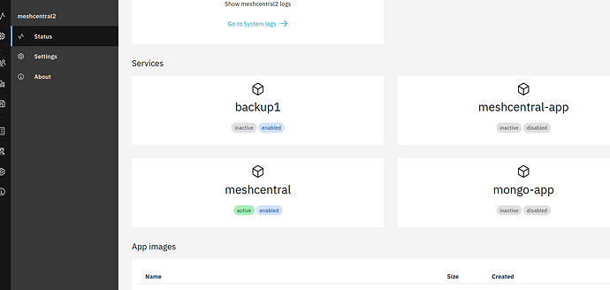

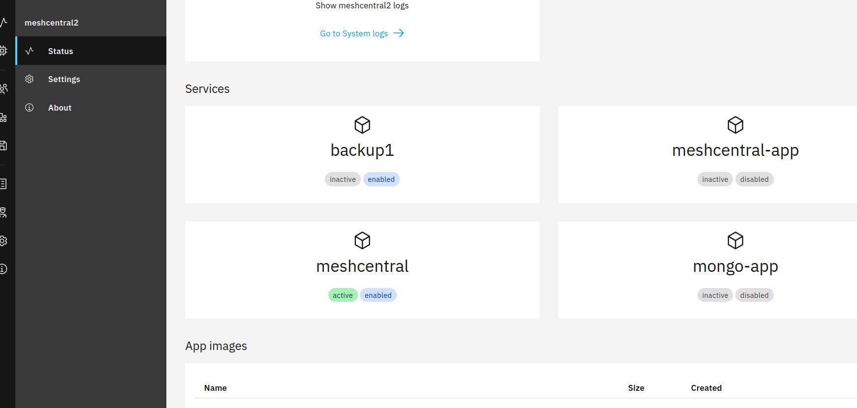

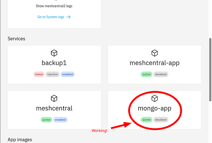

This is what it shows now -
As you can see above, the meshcetnral app is inactive and disabled, as well as the mongo-app.
I thought that the meshcentral install would have started and have a working version of meshcentral. I was also hoping that the working version of meshcental app in NS8 would have a restore backups and autobackups into the now running NS8 meshcentral app. As far as I know, it does not. So it seems that I would have to somehow do it manually through CLI on server.

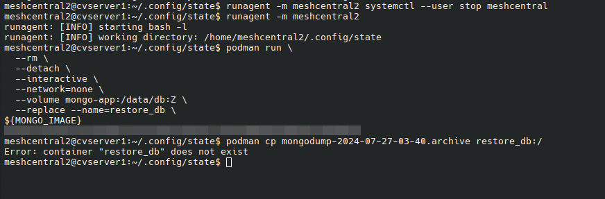

podman cp backup.archive restore_db:/
So for me this should it be as follows -
podman cp mongodump-2025-02-25-03-40.archive restore_db:/
But when I run it, I get the following
Error: container “restore_db” does not exist
Obviously, I have done something incorrectly, but I am unsure if the last commands I did have script object holders or placeholders for the real names of the files.
I must be thinking too hard. :smile:

Well, I am still getting a challenge. Here is a screenshot for you to see what I am seeing when I run the commands.
Thoughts?
It seems the container is not running.

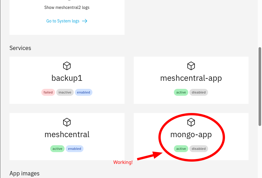

Well I finally got a chance to work out the AVX issue that you had me look in too…
The processor was ok and did support AVX. I changed settings for CPU in Proxmo to HOST at recommendation per the link and info you provided to helped fix the problem with AVX issue.
Sorry it took so long. I had other items pressing. Now that I got that done…
I am still working on importing the data over to the NS8 server and in to MeshCentral. I will let you know what happens next.
Thx!
Ok. I was able to pull over data directory and the database. I got MeshCentral working. Was able to sign in and it looked like groups, users and items where there. But pc’s were not showing any to be active.

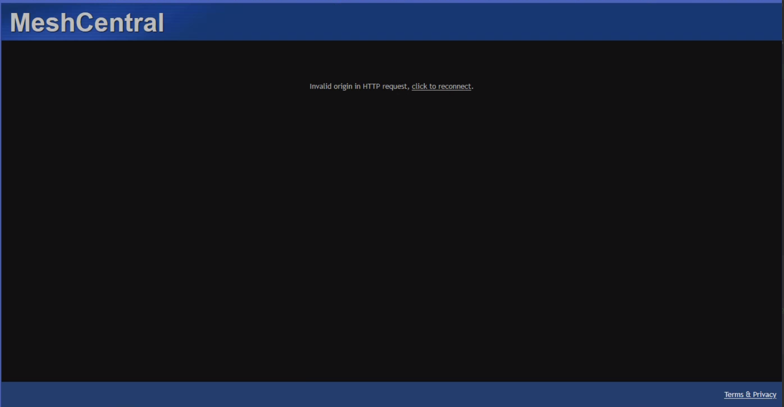

So now that I got it backed up. :grinning: I am seeing computers and groups, but they are all grey’d out and I can not connect to them. So I went to the “Show server error log”. Here is what I found.
-------- 5/22/2025, 3:59:08 PM ---- 1.1.44 --------
(node:34) [DEP0040] DeprecationWarning: The punycode module is deprecated. Please use a userland alternative instead.
(Use node --trace-deprecation ... to show where the warning was created)

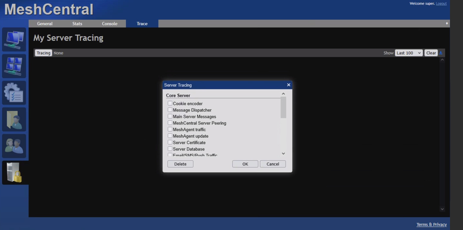

Where would I use “node --trace-deprecation”? I am guessing in MeshCentral. But where in MeshCentral?
I am guessing I would do the trace here in MeshCentral. If so I am not sure what to select to be able to do the correct trace…
I did find this…
I when through it and it had dev saying they had to do something, but nothing that actually points me to an answer that I can see that would help.
Any thoughts?
I also get this depreciation warning, I think it’s not related to the issue and can be ignored.
Maybe a firewall issue like wrong port forwarding or reverse proxy setting so that the agents are not reachable?
Does it help to reinstall the meshcentral agent on a client?
The greyed out device groups could be a permission issue. Maybe try another user?

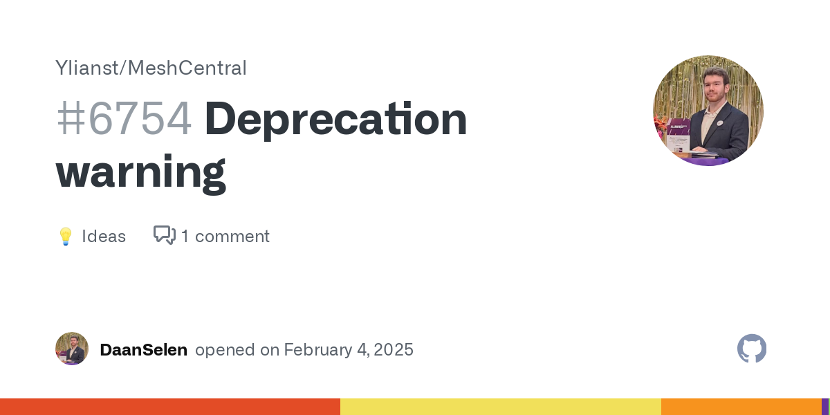

I found this on that has to do with the depreciation warning -
They were pointing to a possible old node js that might be causing the depreciation warning.

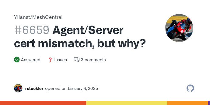

I found this on the meshcentral github-

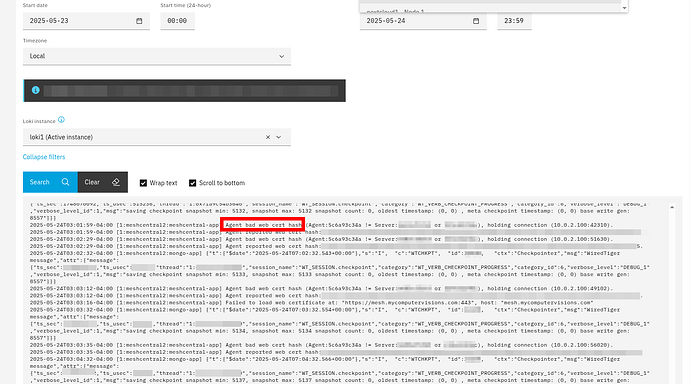

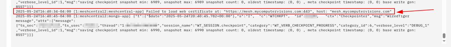

I went into NS8 loki and did a search under APP > MeshCentral - Node1 > Search.
Got the following -
Did not know if I could show some of those items. Wasn’t sure about when it say Agent bad web cert hash?
I also found this… could this be related?

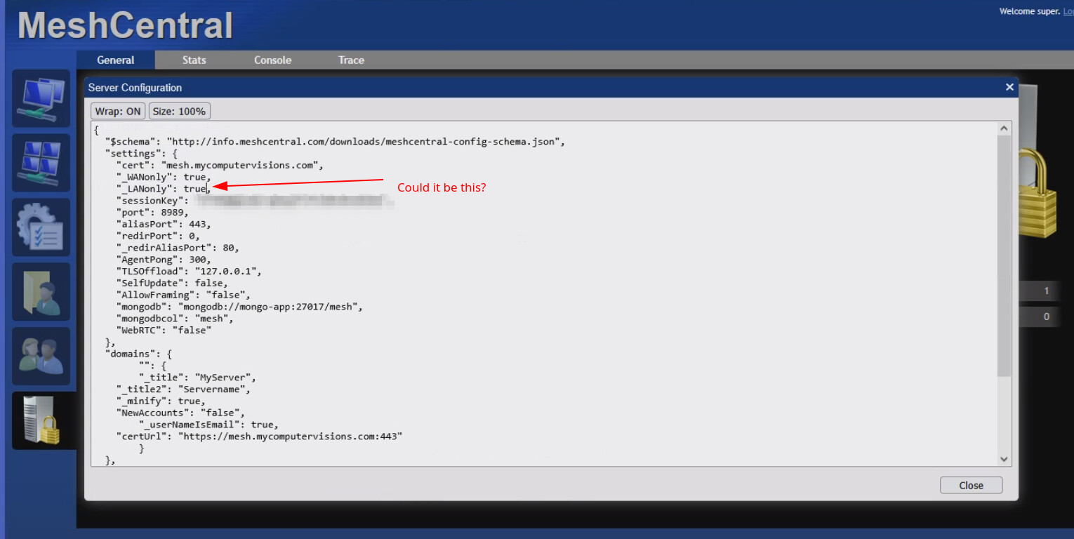

@mrmarkuz Okay hold on… I found this…
Here is my srv config file and the WANONLY" and “LANONLY” settings … you can see it in the picture below.
I tried to change it in MeshCentral… that didn’t work. If that is the problem? How do I get in to the docker and change those to false?
Do you thing setting them to false is the correct move to get the pc’s to become active? That seems to be what they did in the Traefik Reverse Proxy - Agent bad web cert hash Error #4879 I believe…
Yes, but they didn’t update it to version 22 in their container, they still use version 21.
If they don’t update I can do it but I still don’t think that’s the issue as it’s working here with the depreciation warning.
Here is a command to edit the config.json:
runagent -m meshcentral1 podman unshare nano /home/meshcentral1/.local/share/containers/storage/volumes/meshcentral-data/_data/config.json
To get into the meshcentral container to check things:
runagent -m meshcentral1 podman exec -ti meshcentral-app bash
To restart the service after config changes:
runagent -m meshcentral1 systemctl --user restart meshcentral
I don’t think so as these settings are working here but please try it, I could be wrong.
Maybe also the certUrl is wrong.
Consider that settings with “_” prepended are NOT used, so for example to set "_LANonly": true you need to change it to "LANonly":true

Yes, I think your right. I see that in my loki logs for meshcentral.
Isn’t the :443 added by the meshcental setup in NS8 dashboard? I think when you say force HTTPS. right?
Does that setting in meshcentral setup cause the docker to be setup with this settings added in meshcentral NS8 settings / setup?
or do you think it is because it has the url has the :443 at the end?
Should it just be mesh.mycomputervisions.com, or mycomputervisions.com? If not what else would I change the certUrl to cause the “Failed to load web certificate at:” from happening.
I am guessing I would use the same method to change the LANOnly and WANOnly in the server config file to change the certUrl?

Hi @Shadowfire ,
I updated meshcentral to fix a bug in the path of the certUrl, maybe it was the cause that the migration didn’t work.
Thanks to @Shane_Treweek for finding the bug and also providing a fix. :+1:
