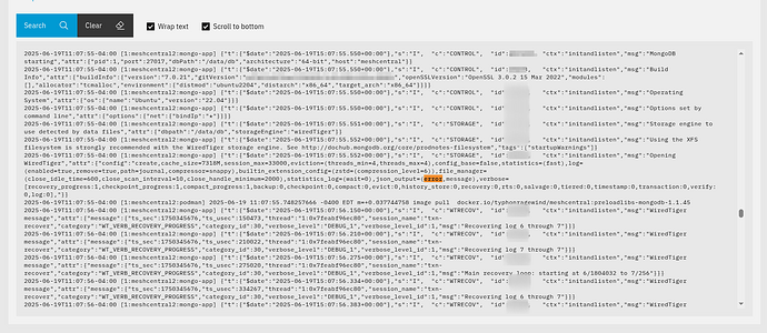

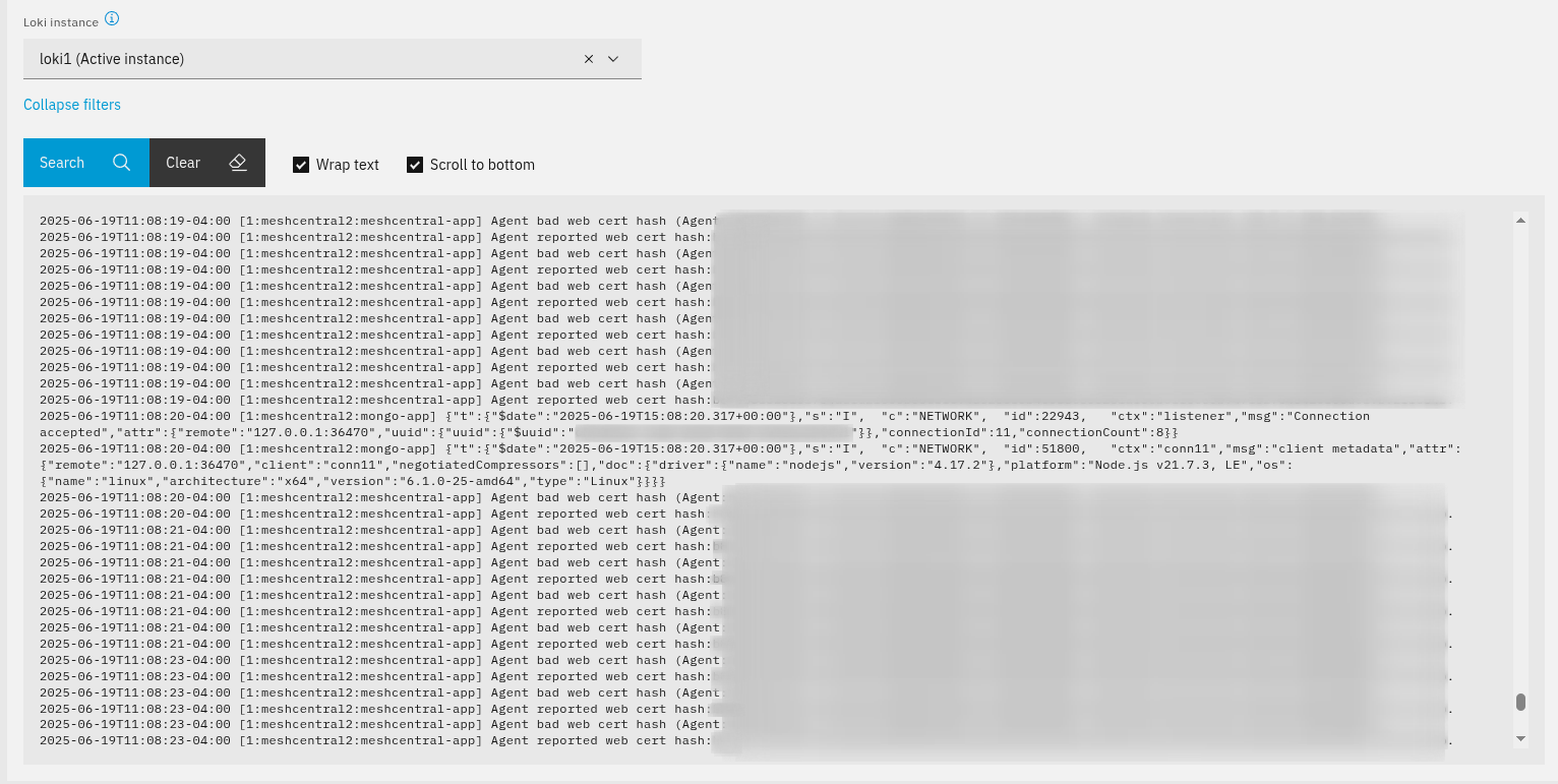

I have gotten busy again. Then I got a chance to take a vacation. I am still trying to figure this out. I have tried to move to a solution, but haven’t gotten far. I am now running MeshCentral Version 1.0.10.
I have a new screen shoot of log with what is now happening after updating MeshCentral from your update you put in.
Not sure if this will help.

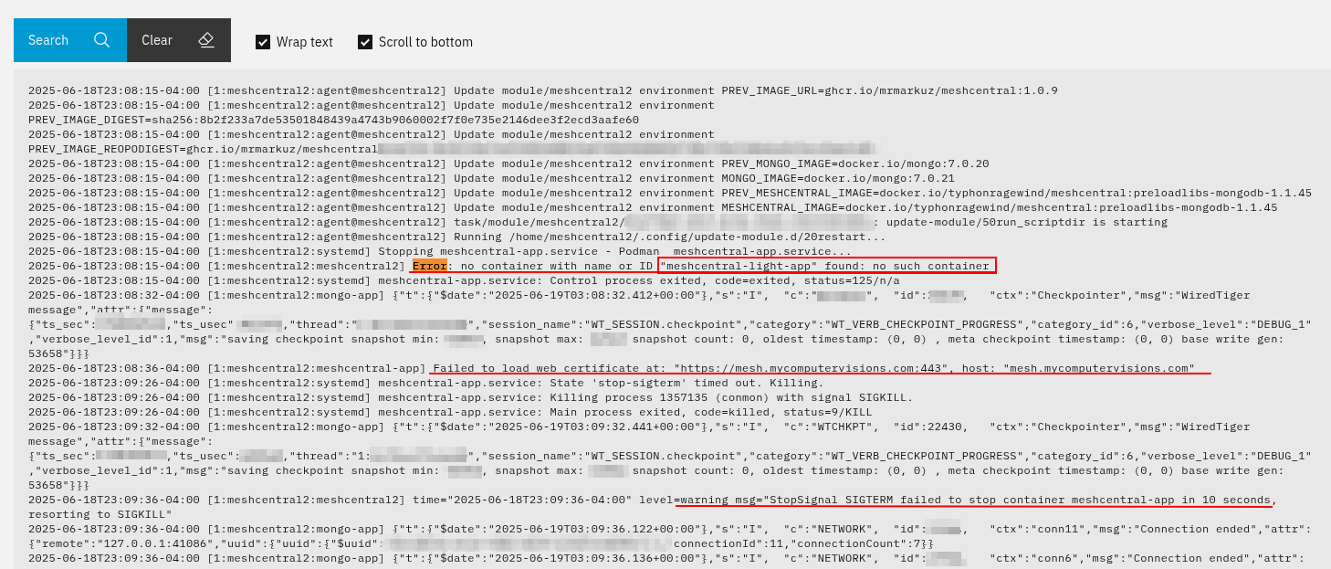

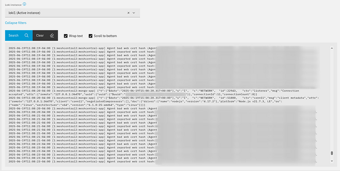

So I did the update to 1.0.11. Here is what I am getting now in the logs for MeshCentral. I still don’t see they connection between pc and MeshCentral. (all pc’s are greyed out) I am still unsure what to do next. But it looks like it may have something to do with the web cert. per logs… of course I am not sure. Still need others help on this one…
It seems the cert doesn’t match to the clients anymore. I’m going to recheck…
Is this something that I need to adjust on my side or is this on the github side of things?
No, I need to recheck the migration. I’ll report my findings.
