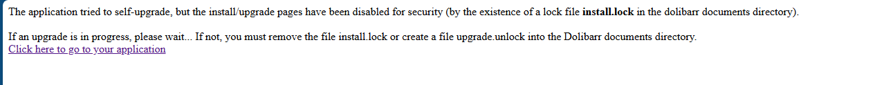

TEsting upgrade cycle between Dolibarr 18.05 to 19.02 and in the process the following error is received
Equally, the message says, creating the file upgrade.unlock into Dolibarr documents directory would also resolve the problem.
so my thinking is.
WHat about creating the upgrade.unlock file prior to upgrade then removing it after the upgrade is complete.
in both instances i dont know if, the newly created file is automatically removed once upgrade is completed, or if a new install.lock file is created if removed before an upgrade.
Any ideas?
tried to ssh into the container, but i cant locate the folder, not sure if am looking wrongly
I think i have an idea on this i will take a look at it later and give you the update
