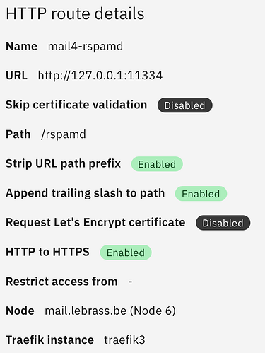

  • rspamd works / EDIT : this module is not behind a reverse proxy :wink:

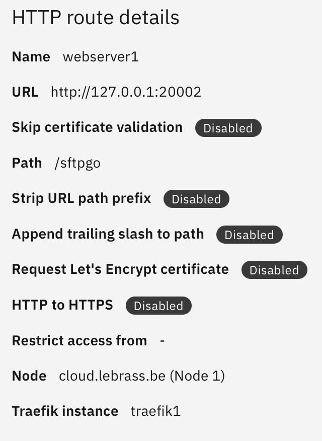

  • SFTPGo not working

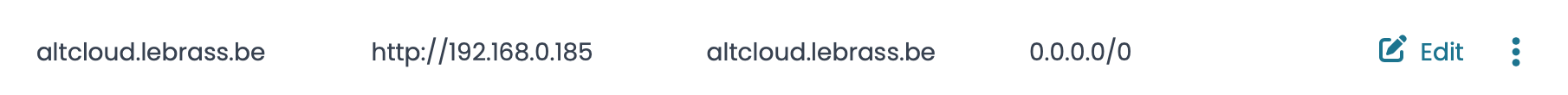

Right now nethsec is configured as follow :
I also defined another one to try redirecting to http
altcloud gives me “too many redirects” when trying https://altcloud.lebrass.be/phpmyadmin (nb : don’t try, I disabled it)
Not sure where and what to look to grasp what’s wrong.
EDIT : phpmyadmin listens to 443 (just tried) so the first reverse proxy definition should work I guess.
altcloud can only work if the nextcloud FQDN is also set to altcloud.

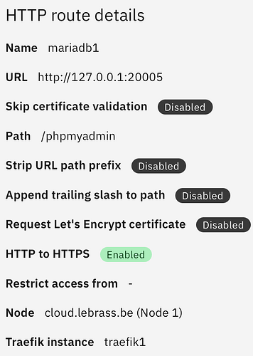

phpmyadmin: node.domain.tld/phpmyadmin
cluster-admin: node.domain.tld/cluster-admin
