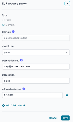

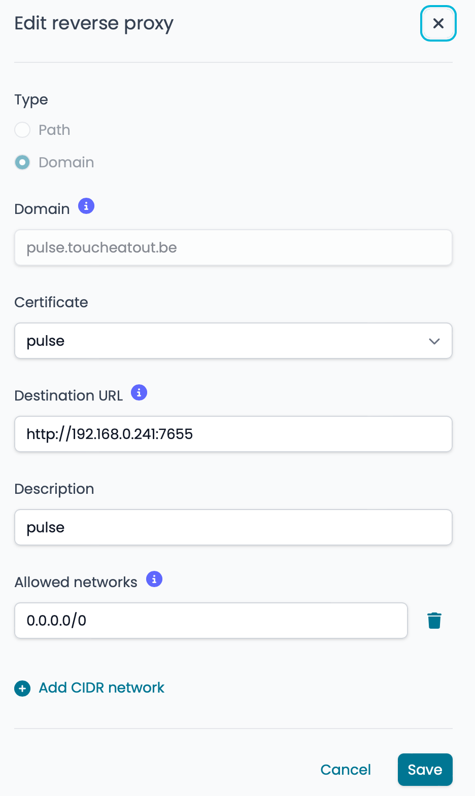

Hello Matthieu, could you share with me the reverse proxy configuration on the firewall?
Websocket request upgrade, headers with original IP and buffer size are already turned on by default, the only thing that could hinder your application is the timeout, but in case of a WS switching, shouldn’t be a problem.
The config is user-first, so your edits should override the webui.
Thanks Tommaso,
Here is the config. Nothing special actually, there are no particular settings.
# cat ns_ae5f1a1b.proxy
location / {
  proxy_http_version 1.1;
  proxy_set_header X-Forwarded-For $proxy_add_x_forwarded_for;
  proxy_set_header X-Real-IP $remote_addr;
  proxy_set_header Upgrade $http_upgrade;
  proxy_set_header Connection "upgrade";
  proxy_set_header Host pulse.toucheatout.be;
  client_max_body_size 1024m;
  resolver 127.0.0.1;
  proxy_pass http://$upstream;
  allow 0.0.0.0/0;
  deny all;
  set $upstream 192.168.0.241:7655;
I tried to add some lines to the ns_ae5f1a1b.proxy file but they were scratched as soon as I did a ngninx reload.
I confess that I don’t really know what I’m doing here, not used at all at ngninx configuration files so I might perfectly do something dumb. Apologies if it is the case. Ready to try any suggestion to get this working.

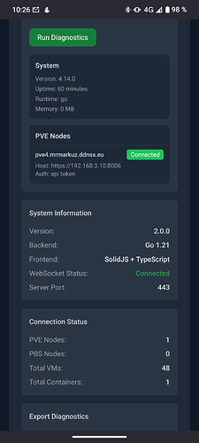

The following should make pulse work:
Edit /etc/config/nginx and adapt the reverse proxy for pulse:
Following options are different on your side, don’t overwrite it
  • The hostname pulse.domain.tld
  • ns_420c686 and ns_1737df38
  • The upstream IP 192.168.3.141
config location 'ns_420c686c'
        option proxy_http_version '1.1'
        list proxy_set_header 'X-Forwarded-For $proxy_add_x_forwarded_for'
        list proxy_set_header 'X-Real-IP $remote_addr'
        list proxy_set_header 'Upgrade $http_upgrade'
        list proxy_set_header 'Connection "upgrade"'
        list proxy_set_header 'Host pulse.domain.tld'
        option uci_server 'ns_1737df38'
        option location '/'
        option resolver '127.0.0.1'
        option proxy_pass 'http://$upstream'
        list set '$upstream 192.168.3.141:7655'
        list proxy_set_header 'X-Forwarded-Proto $scheme'
        list proxy_connect_timeout '7d'
        list proxy_send_timeout '7d'
        list proxy_read_timeout '7d'
        list proxy_buffering 'off'
        list proxy_buffer_size '64k'
        list proxy_buffers '8 64k'
        list proxy_busy_buffers_size '128k'
Generate config:
nginx-proxy-gen
Restart nginx:
/etc/init.d/nginx restart
Show nginx config:
nginx -T -c '/etc/nginx/uci.conf'
Now it should work and pulse looks like
See nginx | NethSecurity for more info.
