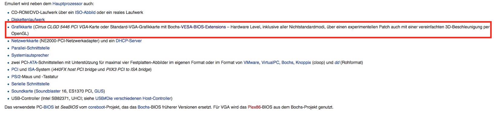

Things look good, those confirmations are for older KVM versions. You can use Intel e1000 for NT, finden the right driver may be an issue (There were so many sub-versions of an Intel EE Pro 1000 Network Card).
Grafik can be cirrus based according to this:
